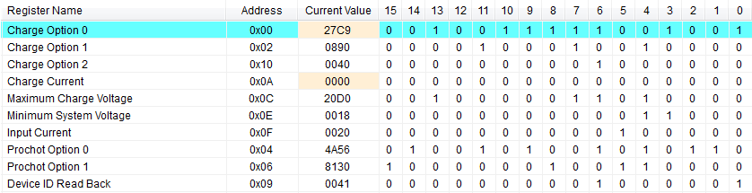

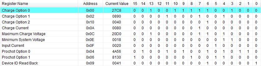

  • Dear Wang,
    The picture below is the register value we set.
    We change the two parts shown on the picture every second to confirm the removal / attachment of the battery.
    If this happens, the part that can not be charged occurs.
    Symptoms can not be reproduced if the register value is not changed every 1 second.
    We need to check Plug and unplug the battery.
    If the battery is fully charged and fully discharged, check the battery plug and unplug.
    Charging setting
    Discharging Setting

    In order to check the plug and unplug of the battery, we change 0bit of 0X00 and 7bit of 0X0A of Addres every 1 second.
    The image below shows the waveform of the BAT connection point when the battery is present and when there is no battery.
    When the above-mentioned function is implemented by MCU, it often happens that the battery can not be charged when the battery is less than 5.2V. Is it possible to see what is wrong?
