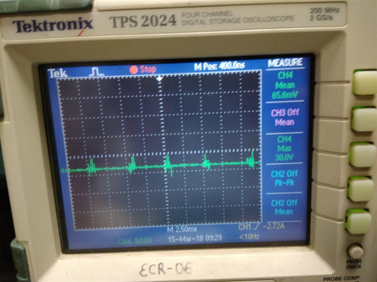

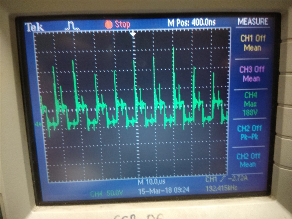

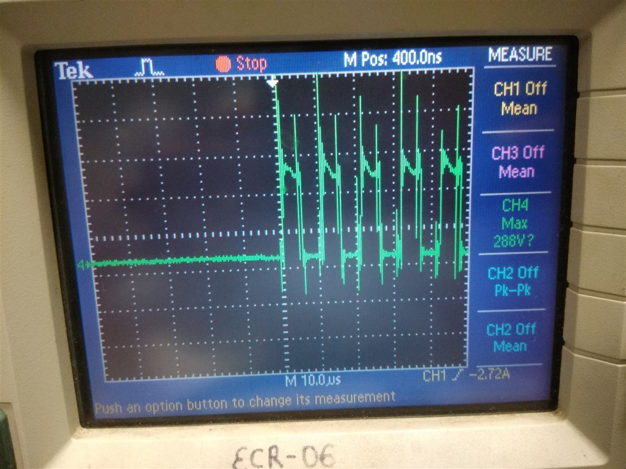

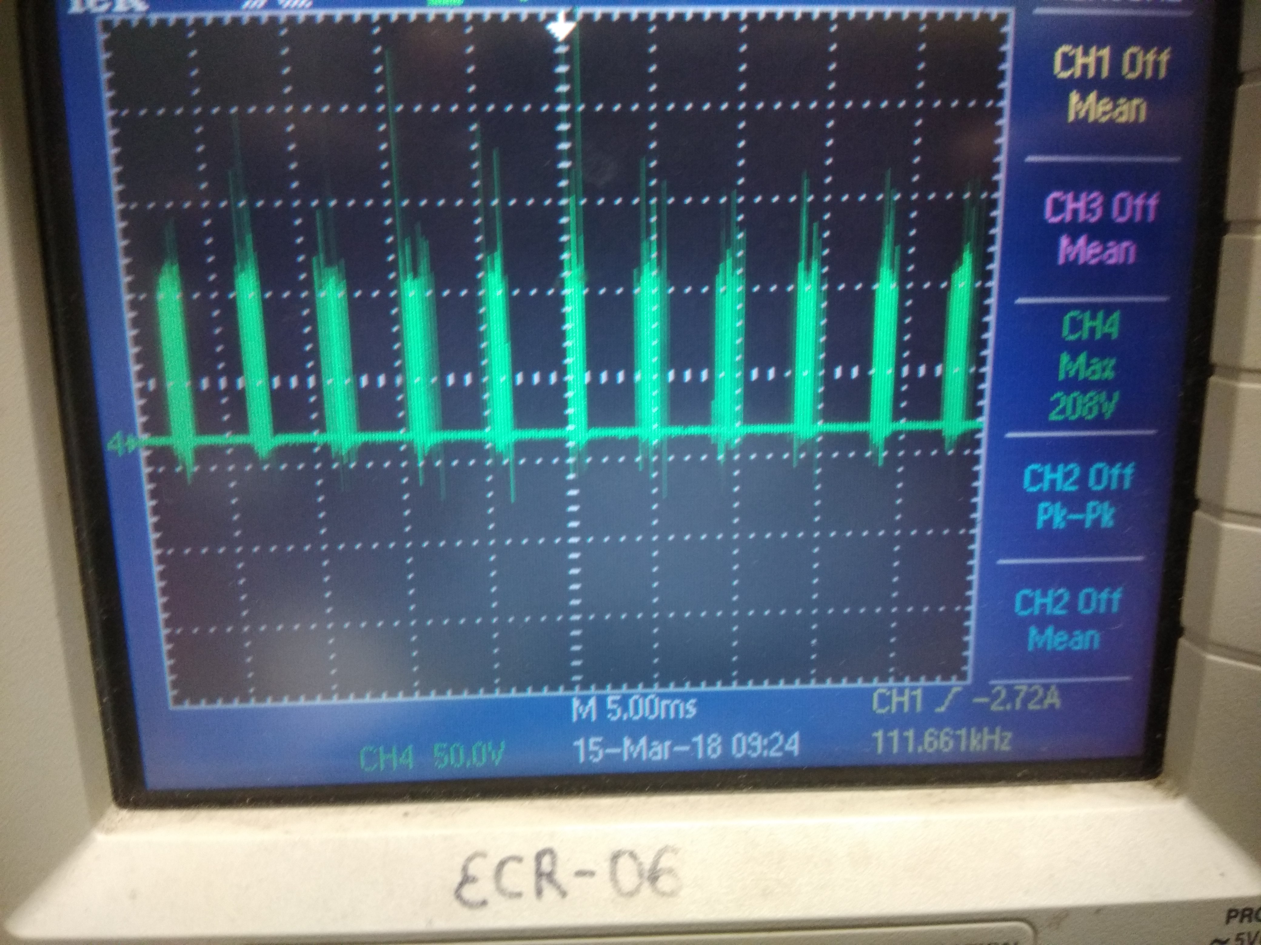

    The waveforms are very noisy and are not clear.
    When I apply 0-120V input for desired output of 20V, the 20V o/p appears at 50V i/p and then it phase shifts till 65V and then goes in burst mode till 120V.
    My concern is why it stays in phase shifted mode for such small band i.e. 50-65V i/p only. Ideally at 50 V i/p and Dmax if 20V is output then even at 120V i/p we should get 20V in phase shifted mode with 20-30% duty cycle.
    Waveforms of drain source and CS pin attached. CS pin there is no signal, even if I disconnect CS pin from the circuit the waveform is same.
    Jignesh C. Patel
  • Hello Jignesh
    You are correct - the waveforms are very noisy indeed and to be honest I think that you will need to 'fix' these waveforms before you can expect the controller to give good results.
    The first place I would start is the PCB layout - The path from the input capacitor to the MOSFETs in the bridge circuit must be a low impedance - short, direct tracks - you probably have the current transformer in this path somewhere - that's ok. The connections from Drains of the lower MOSFETs to the Sources of the upper MOSFETs must be short. The connection between the Drains of the upper MOSFETs must be short. The connection between the Sources of the lower MOSFETS must be short.
    The length of the connection from the mid point of the Left Hand MOSFETs to the mid point of the Right Hand MOSFETs should  is not as important as that of the other connections I mentioned above. This is because any inductance in this path will add to the transformer leakage inductance.
    I don't like the way that the drain voltage seems to drop gradually when the MOSFET is off so I would also confirm that the high side gate drives are working properly.
    The layout of the output rectifier circuit should also be reviewed.
    I wold also suggest that you review the layout around the UCC28951 controller - make sure that NONE of the OUTx tracks run under the IC or parallel to any sensitive input - especially the CS input.
    You could run the system at a low input voltage - say 20V or so - it will run at Dmax but it will give you an opportunity to investigate your layout.
    The current sense signal is not a control variable in Voltage Mode Control  so you can safely tie that pin to GND for initial investigations. Just be very careful not to short or overload the output terminals, because without the CS signal you have no current limit protection - this is ok for initial investigations BUT not for the finished product.
    I would also consider removing the feedback circuit completely and controlling the duty cycle directly from a potentiometer at the EA+ input - as I described earlier. This will reduce the number of variables in the system and help to diagnose where the instabilities are coming from.
    Once you get the waveforms cleaned up you should notice an improvement in the systems behaviour (it may not behave ideally but it should work a little better)
    One small point is that you did not label the traces you posted - It makes it a little more difficult to understand what they are showing - it was ok in this case but in general a label helps.
