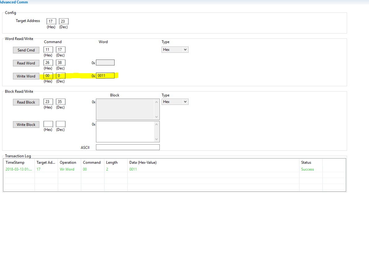

    I'm still having a number of problems both when forcing the sleep mode and when trying to test with the in system sleep. I've loaded on the R1 firmware as instructed however my issues are with how to actually configure the board to go to sleep once I release the load from the pack terminals.
    I'm still having problems getting the board into Sleep Mode. It seems that the command for 0x0011 does not change the SLEEPM bit of operation status as it explains in the documentation. I'm using the Advanced Comm SMB window and  using the following

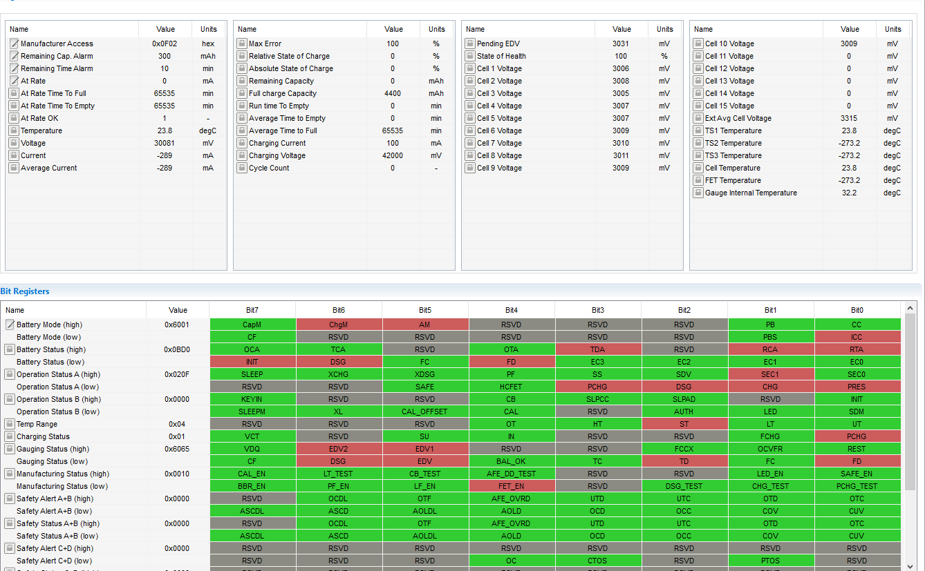

    Which I would expect to change the SLEEPM bit of operation status here(after I refresh the registers)
    The other issue I'm having is effectively tripping the in system sleep mode. I can set the DA Config and the Power config such that I would expect with no load that the board would shutdown after about a minute. I'm setting Auto Ship time to 1, the AUTO_SHIP_EN on and the in system sleep bit of DA config. To test I'm disconnecting my 100 Ohm load from the board and disconnecting my communications from the SMB connector. I'm setting the LEDs on the board before disconnecting to see if they turn off at shutdown. I'm not sure if this is a valid test, but the LED's toggle off after a minute, which I suppose indicates the system is off.

    The SleepM bit in operation status is a trick. I expect it gets set, but if you try to read it you have awakened the gauge and it will not show set. Also the bqStudio dashboard reads periodically so it will wake the part or keep it from going to sleep. The refresh is 4 s and the bus sleep time default is 5 s.
    You have an EVM, so probing the circuit should be easy, it has a number of test points you can fit a probe into. To observe sleep, I would suggest the following sequence:
    1. Program the firmware so you know the settings are default.
    2. Click the Auto Refresh in the bqStudio dashboard to turn it off, it should have a red highlight.
    3. Probe the SDA test point and CHG test point with a scope probe. The SDA test point should show a sequence of activity every 250ms. Set the scope to about 1s/div. CHG should be low.
    4. In the commands panel, set the FET enable. CHG should go high if conditions are normal.
    5. Send the MAC sleep command as above. Within 2 seconds you should see the CHG go low and the character of the SDA signal change, SDA should be less dense but still on the 250ms period. The part is in sleep mode.
    6. Refresh the registers pane in bqStudio. You should see CHG go high again and the SDA change back to a more dense communication. It is awake. Enabling the dashboard will do the same thing.
