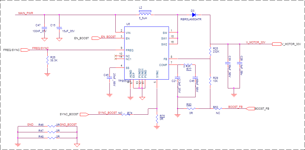

TI recommended IHLP5050FDER5R6M5A Inductor (It is too big to my board), It is possible to use 744316560 (Wurth Electronics) Inductor?
Vin= 4.5 to 12V
Vout=30V
I= 0.6A
Vin= 4.5 to 12V
Vout=30V
I= 0.6A
According to the calculate, you need to use a >6A current rating inductor. Please attached the datasheet of the Wurth inductor, I can't found it.
The Wurth inductor's currrnt rating is too small, suggest they use coilcraft one, XaL7030, please check the5140.xal7030-102ME.pdf attached DS.
