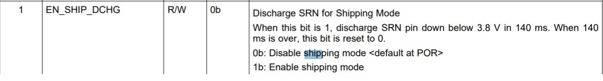

Hi Sir
I saw BQ25703A use /BATDRV to drive a PMOS on or off
I think battery will supply Vsys through PMOS body diode when adapter is not exist
May I know why SRN down to 3.8V can support shipping mode
Have any document describe this
