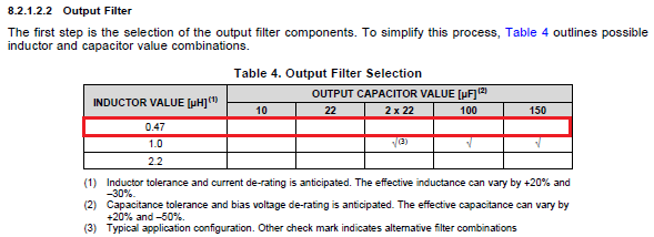

Hi Team,
Does TI recommend L=0.47uH for TLV62095 although there isn't check mark in Table 4?
If the answer is yes, I would like to know recommended Cout value.
Yaita / Japan disty
  • Hello Yaita,
    thanks for reaching us on E2E. The datasheet does not recommend 0.47uH as inductance value.
    This value is there because part of a standard table that gets filled out with the chackmarks correspoding to the L-Cout combinations that we verify and recommend.
