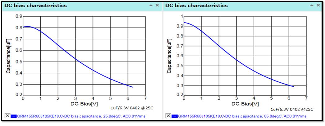

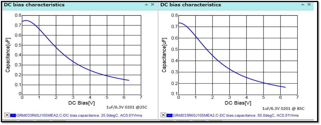

  • Hi Phil,
    Thanks!   We have the same questions for VBATTBKUP/VDDIO1/VDDIO2 pins.  Can we replace the original cap (1uF/6.3 0402 X5R +/-10% ) by 1uF/6.3 0201 X5R +/20%  as shown below?
    0402 cap:
    0201 cap:
    Thanks!
    Antony
  • Hi Antony,
    It totally depends on how much margin with your current design. Principally, a good design doesn't have too much margin, so, the power out capacitance can't be reduced.
    The best practice is by a few experiments with a few boards in different temperatures to make sure the change is doable.
    Thanks!
    Phil

  • HI Phil,
    Regarding the question about replacing the original cap (1uF/6.3 0402 X5R +/-10% ) by 1uF/6.3 0201 X5R +/20%  for VBATTBKUP/VDDIO1/VDDIO2 pins, is your major related to the accuracy of 10% vs 20% or the size of 0402 vs 0201?  Customer has some more questions as below.
    • How about using two 1uF/6.3 0201 X5R +/20%  caps to replace one 1uF/6.3 0402 X5R +/-10%?  Would it be ok?
    • How about using one MLCC 1UF/16V (0603) X5R 10% to replace one 1uF/6.3 0402 X5R +/-10%?  Would it be ok?
    • If above options are still not acceptable, please provide some reasons.
    Thanks!
    Antony
  • Hi Antony,
    It's more related to the accuracy of 10% vs 20%. For VBATTBKUP/VDDIO1/VDDIO2 pins are connected with 3.3V power level, so, using two 1uF/6.3V 0201 X5R +/20% caps to replace one 1uF/6.3 0402 X5R +/-10% is the best.
    Thanks!
    Phil
