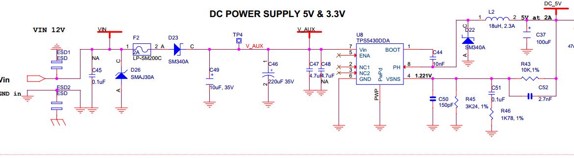

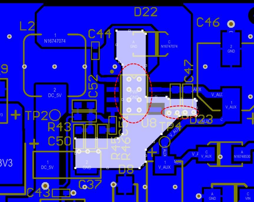

I have implement the TPS5430 in my devise.
I made pretest in certification labs and find that i have exception from radiated emission from DC/DC.
1. do i made layout correct ?
I have made own GND to DC/DC, is it correct? I connect to common GND with VIAs (Marked in red) or i need make one GND ?
2. Do i need connect a common mode choke before switching power supply (TPS5430) please advise.

  • Hello
    I made pretest in certification labs and find that i have exception from radiated emission from DC/DC from 100 - 200MHz
    2. I have made own GND to DC/DC, is it correct? I connect to common GND with VIAs (Marked in red) or i need make one GND ?
    3. Do i need connect a common mode choke before switching power supply (TPS5430), if yes, do i need a capacitors for filter (where) please advise.
