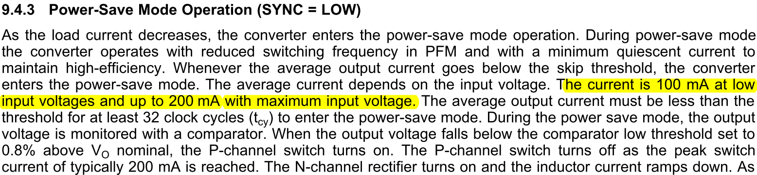

    The data sheet shows the following contents.
    I would like to show that the threshold differs with spec variation of parts of TPS62050.
    Please tell me the followings.
    ・Could you tell me specific voltage of "low input voltage" and "maximum input voltage".
    ・Please advise on the spec variation related (Fsw etc..) to the threshold of PFM mode.
    ・Could you tell me the formula to enter PFM mode.

  • Hi Yusuke-san,
    Yes, the exact threshold will vary over temperature, Vin, and part to part. We do not specify this variation. Low Vin refers to 2.7V and high Vin to 10V.
    If it is critical to not operate in PFM mode, then they can actively toggle the SYNC pin high or add more load current.
    The only variable in the PFM/PWM point is output current.
