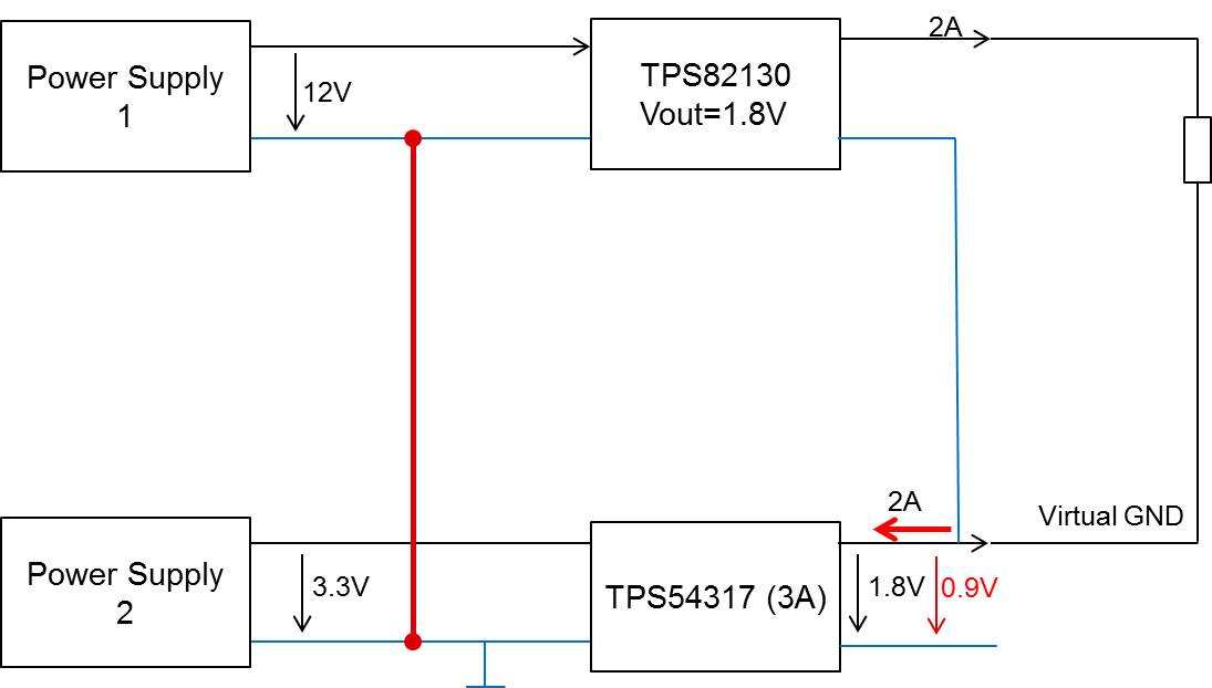

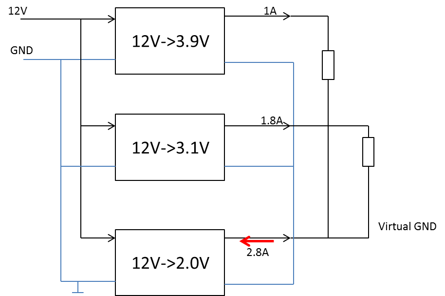

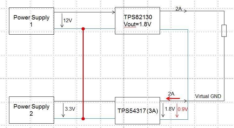

Hello Team,
in order to move the common mode voltage of an ADC I need a virtual ground of 2V. On top of this 2V I need 1.1V@1.8A and 1.9V@1A. The ADC is shown as resistors in the block diagram below.
Can you recommend a solution for this problem, please? I looked at TPS54620 but its Low-side switch sinking current limit is 2.3A typical.
Thanks and Best Regards,
