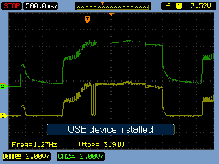

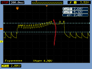

As the figure below from a measurement on VRECT suggests, there is some communication but then the voltage drops again. This figure is from a measurement without a battery connected, another measurement with battery showed the same curve, only the voltage dropped earlier: around the moment that the curve from this plot becomes flat before the two last spikes.
Is there an explanation for the almost triangluar waveform before and after the increase in VRECT?

    The scope capture show a good start up (first three pulses) and tuning (pulses every 30mS) to desired operating point, then load in enabled.
    A pulse then a drop in output suggest the RX sent an End Power Transfer (EPT) to turn off the TX. Also the TX does not try to restart the RX, low power ping checking if the RX has been moved (Triangluar waveform).
    Any LED on the TX indicating fault or charge complete?
    Which TX are you using?

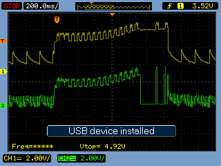

    Thank you for your fast response! The TX is a custom-made design of which I do not know much details. It was verified that it did work before (with the other Qi RX chip)There is a feedback LED present which is blinking during charging (but also when the battery is full). I see this LED blinking about 2 times and then the LED goes back to constant (waiting for RX). I have added the scope capture of both the VRECT (TP12, top) and CHG (TP10, bottom). The LED on the EVM also blinks twice (as indicated by the two low values on the graph).
    I also did a scope measurement with another off-the-shelf RX (Qi charger for Moto 360 Smartwatch) and this came out. Another response, but still no battery charging.
    Does this clear things up for you?

    Both TX seem to try and start charging but then TX will stop, possibly on command from the RX.
    What does the battery voltage look like?

    Your comment on the communication and tuning looking good, made me think about current settings. I am just using the EVM with adaptation to the coil, tuning caps and COM caps. I was checking all the jumpers and potentiometers and then I came to the R13 pot for the termination current. The battery I used was at 3.8V, which I thought was low enough but apparently it isn't. The current must have fallen immediatly below the termination current. When I lowered the R13 pot for lower termination current, the battery seemed to charge again.
    Thank you for bearing with me and verifying the VRECT measurements.
