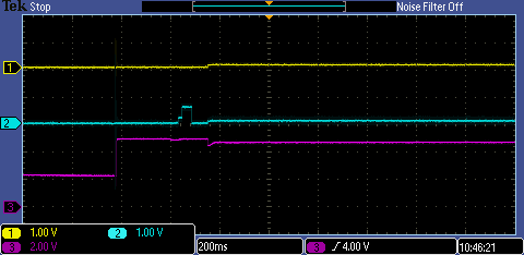

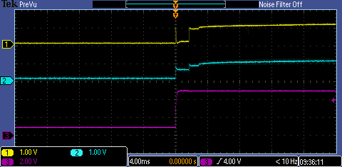

  • CH1 & 2 are D+ and D-, CH3 is USB Power from PC. iMX6 power is off.

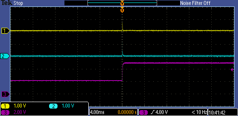

    Same as above, but now the iMX6 power was already on when the USB power from PC was applied
    Same as above, iMX6 running, connect to PC USB

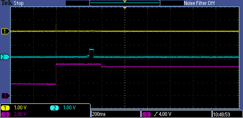

    Same as above, iMX6 running, connect to Battery Charger (no USB Data)

    From the scope captures, I also have several questions:
    Capture 1/4: The D+/D- lines seem to rise up to float up to some value. In this test, are those lines (USB_OTG_D_P and USB_OTG_D_M in your schematic) floating as well? This is where the iMX is powered off, so I assume the D+/D- lines are floating.
    Capture 2/4 and 3/4: What is the difference between these two tests? The test conditions sound very familiar, where the iMX is already running, and then PC power is applied, but there are two different waveforms I see. Is there something different between iMX already powered on and iMX already running?
    Capture 3/4 and 4/4: These look almost identical. That blip on Capture 3/4 on the D+ line is the typical waveform seen during D+/D- detection on the charger. Is Capture 3/4 with the charger present as well?

    Capture 1/4 is with one end of the USB cable plugged into a PC (host) and then plugged into our circuit with the power supplies off (except for the BQ24297 which has the battery voltage applied. The trigger is the rising edge of the +5V from the USB (PC), the data lines as shown. I'm can't say for sure if the iMX6 is "floating" ie. Hi-Z or if (because it is unpowered) it presents some parasitic load.
    Capture 2/4 and 3/4 differ only in the time base of the oscilloscope. You can read it from the screen. Capture 1/4 and 2/4 are 4ms/div, Capture 3/4 and 4/4 are 200ms/div. I wanted a longer view in case something interesting happened after the initial connection.
    Capture 3/4 is with the iMX6 running (powered on) and then connected to the PC. the connection timing is the rising edge of trace 3.  Capture 4/4 is the same condition but the power is a USB wall-wart charger, which provides the 5V charging voltage to the system but has no active data lines.

    2/4 and 3/4 have the iMX running, and the bq24297 not connected.
    4/4 has the iMX running with no USB data and the bq24297 connected.
    Do you have a waveform showing the behavior, where you have USB communication and the charger running?
    Joel H
  • 2/4 and 3/4 have the iMX running and the BQ24297 connected
    4/4 has a charger (with no data lines) connected and the BQ24297 connected.
