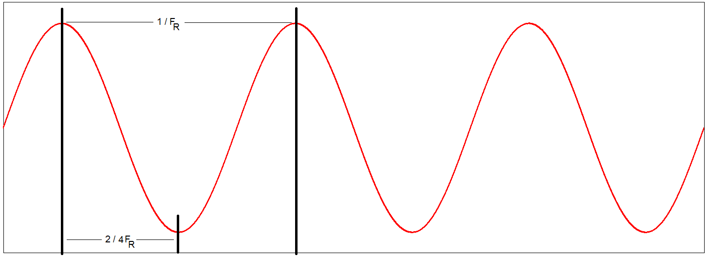

  • Thanks Samrat - I found it.
    The resonant transition must take at most one half of the resonant period of the tank circuit (Ls and C). I don't know why the equation was expressed as 2/ (4*Fr) but I think the diagram below shows that the time is actually 1/(2*Fr). The reference to the tank frequency being four times higher than the maximum transition time is misleading - the tank period should be about 4 times longer than the transition time. The reason for the resonant period being 4 times the transition time is to provide some buffer time, during which the body diode of the MOSFET is conducting, to allow for variations in the IC and transition timing. If you haven't turned the MOSFET on by 1/ (2*FR) the resonance will continue and the MOSFET drain voltage will increase again and you lose ZVS.
    Colin

  • Hello Samrat
    Yes, I'm afraid that SLUA107A is a bit ambiguous in this regard.
    The resonant period will start when the top switch is turned OFF and will ring with a frequency of fR. The RATE at which it charges the capacitance at the switched node will depend on the current in the inductance at the moment the switch is turned OFF so the TIME needed for the node to be charged from Vin to 0V (at which time the body diode of the low MOSFET turns on) will be shorter at higher currents. If the current is too low there may not be enough energy to charge the node all the way to zero and you will not achieve ZVS. Note though that even if you charge only 50% of the way down and then turn the LOW side MOSFET on you will incurr only 25% of the switching losses that you would if you hard switched all the way from Vin to 0V.
    Now, assume that there is enough energy (current) in the inductor to ring the node down to 0V - this current will then flow in the body diode. The current will reduce at a rate di/dt = V/L where V is the input voltage (during this time the full input voltage appears across the leakage inductance (shim inductor). Eventually the current will reverse and the body diode will turn off. The switched node is then unclamped and will ring up again. The trick is to turn the low side MOSFET on before this happens.
    The same argument applies for both positive and negative going transistions - note that the Left hand leg (QA/QB) transition is different to the Right hand leg transition - this is explained in http://www.ti.com/lit/slup102 , http://www.ti.com/lit/slup101
    You are right, if you wait too long to turn the MOSFET ON you will lose ZVS because the node will ring up again, if you don't wait long enough you will turn it ON before the node rings down fully again losing ZVS.
