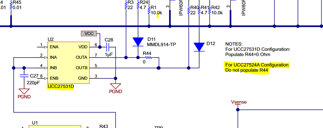

  • Hi Ganesh,
    Thanks for your update and schematic. This schematic from TIDA-00779 mention two configurations for two different drivers, one is the UCC27531 and the UCC27524A. The Figure below highlights this.
    The pinout shown is actually the pinout for the UCC27531 which is the single split output driver in which R44 (same as R120 on your schematic) would be needed to sink current. In the case of using the UCC27524A you would not populate R44 since there is a driver channel for each power MOSFET. Since you have R44 populated, some of the turn OFF current is making its way to VDD and not to GND damaging the device.
    Please let me know if this answers your question!
  • Dear Jeffery,
           Actually  In our prototype board we didn't populate the R44.(As per your Instruction)
    everything, we are testing based on your TIDA-00779.
    Ganesh

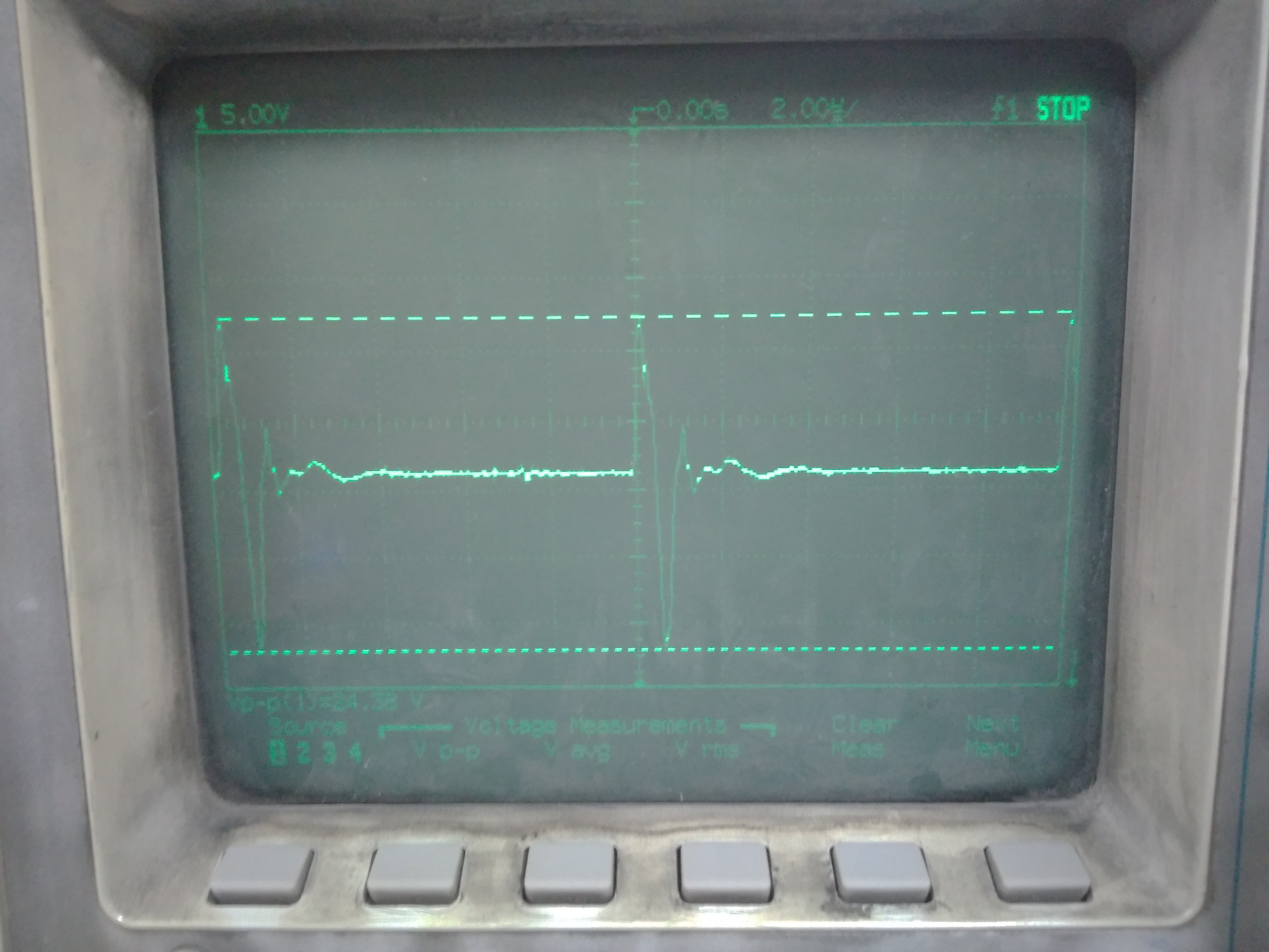

  • HI Jeffery,
    This is the wave form we captured during switching on PFC system, But the failures occurred during ideal condition when auxiliary power supply switched on.
    1. the IC got during the load whenever we cross load more than 2-4A, Sometimes During switching On PFC and some times when it is in ideal condition.
    Thanks & Regards
    Ganesamurthy.S
  • Hi Ganesh,
    Thanks for your update, to confirm the scope shot, this is of VDD? and where is GND located on this scopeshot or can you confirm how high VDD reaches?
    also, the aux supply your referring to is the 5V supply connected to J12 or the 12V supply connected to J8?
    I noticed that TIDA-00779 needs an external bias supply to power the gate driver (among other things). You are generating this 12V external bias in the 'power section' of your schematic with a flyback topology. If the scopeshot is from VDD then could it be possible that this 12V flyback supply is experiencing too much flyback exceeding the 20V abs max rating?
    I see there is also a clamp at the pri/sec to limit the voltage spike caused by the leakage inductance. A lower value for the clamping resistor, Rclamp=R146 can be used to discharge Cclamp, R92, quicker by dissipating the stored leakage bringing the node back to the initial switching state. Similarly, series resistor R148 for example can be reduced so that Cclamp can better handle the high peak currents during turn-off. Likewise, C90 on the secondary can be increased to limit the voltage rise while still absorbing the leakage.
