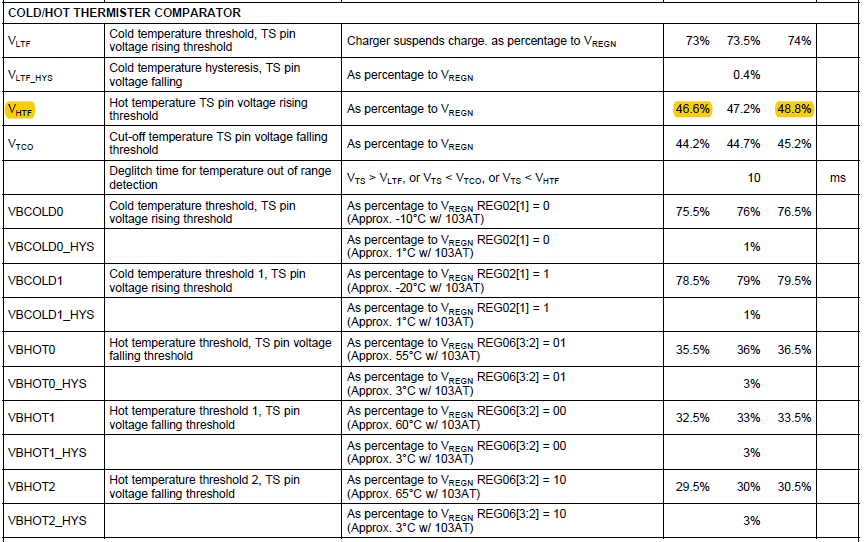

Hello.
Please kindly help me to check BQ24298 SPEC Vhtf Max value is 47.2% + 0.6% = 47.8% or 48.8%. Thanks for help~
