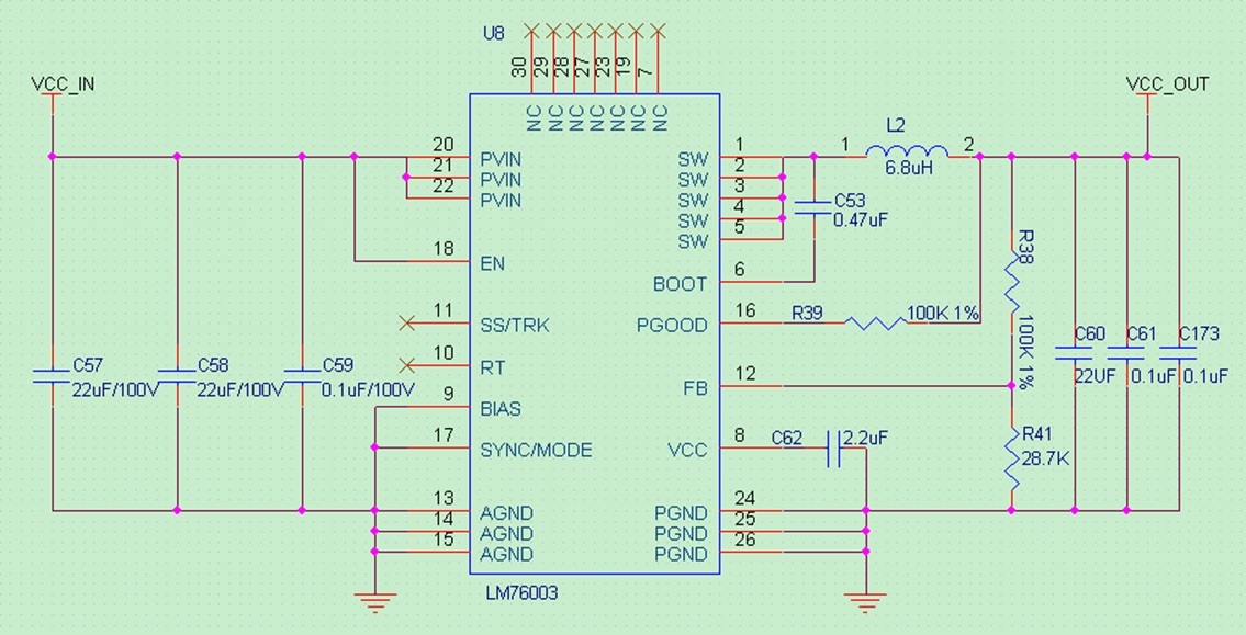

Hi AE/SE team,
Could you please help review below design schematic with LM76003?
Vin:48V
Vout:4.5V
Iout:<2.5A
Best Regards
Iven Xu
