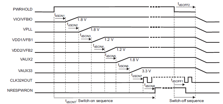

Regarding to power-off at EEPROM mode on TPS65910AA1, my customer is asking a question.
(Question)
・In this mode, does it need DEV_OFF or DEV_OFF_RST control bit for power-off?
According to datasheet page 47, these control bit are set to 1 for power-on disable.
But it seems that power-off sequence is started by falling edge of PWRHOLD on figure 5-2 (D/S page 39)
and figure 3 (User's Guide page6).
Is only PWRHOLD control needed for power-off at EEPROM mode?

  • Power-on disable conditions only prevent the device from meeting the "power-on enable" requirements.
    In other words, if the device is in the OFF state, the PMIC will not be allowed to go to the ACTIVE state if:
    • PWRON = low, OR
    • Die temp > thermal shutdown limit, OR
    • DEV_OFF bit = 1b,or DEV_OFF_RST bit = 1b
    But when the device is in the ACTIVE state, the only requirement to sequence-down and go to OFF/SLEEP states is to pull PWRHOLD pin low.
