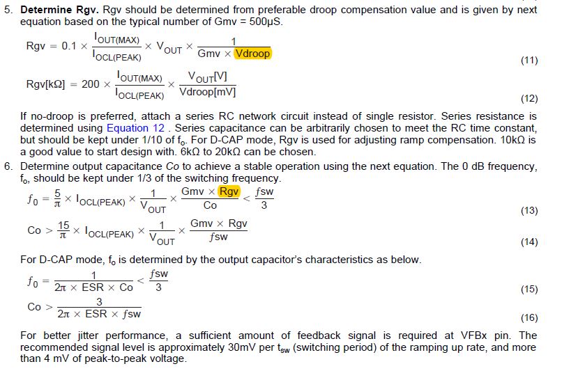

As stated in the TPS51220A datasheet, Rgv is needed for determining Co.
Now, Vdroop is needed for determining Rgv. However, I have no idea about how to obtain Vdroop.
Could you please advise?

  • Hello, Roy,
    Normally, Vdroop is set as 1% of Vout voltage. Vdroop must be less than 3% of Vout.
    best regards.
    edwin.

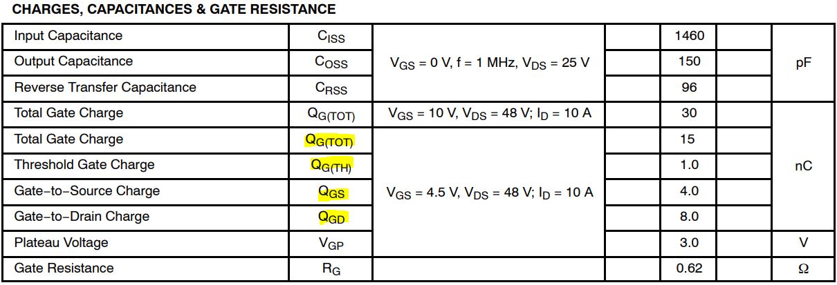

    1. Driving capability
        My customer uses 2 MOSFETs in parallel at both the high and low side. How do I know if TPS51220A is capable of driving the FETs?
        Is there any systematic way to calculate this?
        The MOSFETs used is:

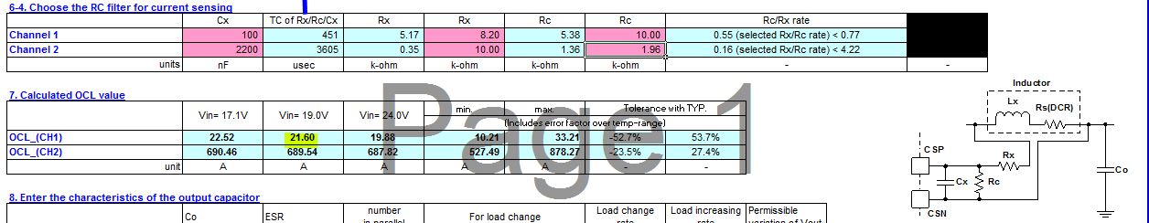

    2. Overcurrent Limit
        The result I got using Eq. (20) in the datasheet is different from the one in the TPS5122x Calculation Tool attached below.
    Besides, the OCL value also varies with input voltage which doesn't match Eq. (20).
    Could you please let me know what's the correct way to calculate OCL value?

  • Hello Roy,
    1, In MOSFET datasheet, you can find Qg total.
    In TPS51220A datasheet EC table, you can find DRVH/DRVL resister.
    so you can calculate switching rise time and fall time using below equation:
    5/DRVH resister *t= n* Qg.
    n is quantity of MOSFET.
    if rise time/fall time is about 10ns -20ns. it's OK.
    2, please follow datasheet to calculate the OC value.

  • Hi Edwin,
    1. There are many Qg parameters in the datasheet. Which one should I use and why?
    2. So Vin should not affect the OCL value, right?
    Actually I couldn't find the TPS5122x Calculation Tool on our website, can we still use that as reference?

  • Hello Roy,
    1, you should use Qg(tot). MOSFET is fully open until it is charged Qg(total).
    2, Actually, there is very little difference about the OCL value at different Vin. We can ignore it. if you want know, I can try to explain to you by email.
    yes, we still use that as reference.
