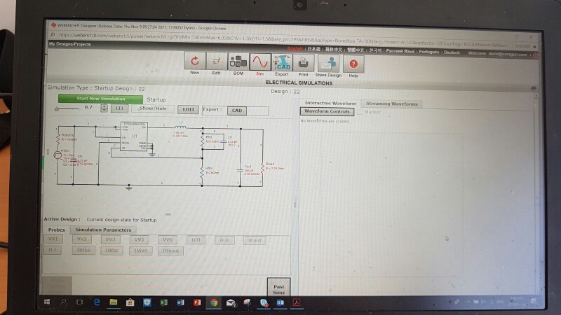

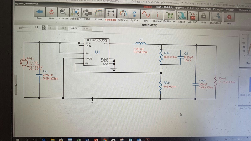

In my systems, there are many Ceramic capacitors at the DCDC output.
The capacitors are used to bypass different loades (FPGA etc). I would like to simulate the effect of those capacitors and the different loads (resistors and current sources). The low ESR of the capacitors may cause instability.
I have tried to use Webench and modify components, but as you can see that the probes are disappear. You can see the DC/DC design parameters in the pictures.
I need TI to set for them a test bench so they can simulate their circuits with Webench, Tina or other simulator where they can add extracted PCB parasitic and add capacitors resistors etc.
I will also need a tutorial how to run this. I spending too much time is fixing stability problems with LM26484 (I will appreciate if you can get them a test bench for this PN too).

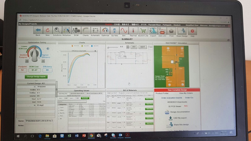

IMG-20180322-WA0001 – Start design of TPS62065 with the Webench
IMG-20180322-WA0002 – Suggest design
IMG-20180322-WA0003 – Design after change the output capacitor from 10uF to 100uF
IMG-20180322-WA0004 – When I try to Sim the probes disappear
Shlomi

  • Hi Shlomi,
    Thanks for sharing your design details and your problem. It looks like you have already configured your design to your liking and are just looking to simulate and check out waveforms for stability analysis. In the last step, you need to click on "Start New Simulation" and once the sim is completed, you should be able to see the probes.
    I have recreated the same design for you here and simulated startup testbench in this design: webench.ti.com/.../SDP.cgi
    You can open this design and click "Sim" -> "Past Sims" (lower part of screen) and then clcik "View" to view results. You can click on any probe and see the waveforms. Hope this answers your question. If you want to add multiple caps apart from just the 100uF, you can use the standalone TINA-TI model reference design located at: www.ti.com/.../toolssoftware and simulate it there.
