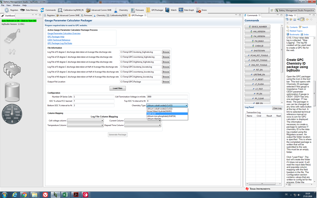

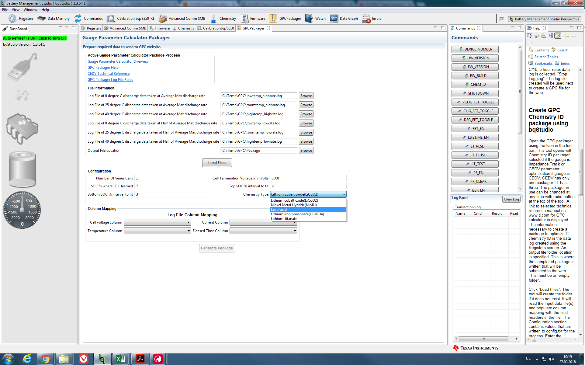

    Q5: Im working with a Lithium-Polymer Battery. I cant choose this type of battery, because this type (Lithium-Polymer) is not listed, as you can see.
    What can I do to be able to choose Lithium-Polymer Batterys?

    First is the chemistry ID which can be loaded into the bq78350-R1 to estimate the state of charge from the voltage on wake up (boot). This can be picked from the Chemistry tab in bqStudio for the bq78350-R1. You can browse the list and select the cell or closest type of cell. You can also record a log and submit for matching the chemistry if desired. This is typical for impedance track gauges, but less critical with the bq78350-R1 since it is CEDV gauging. The tool for matching chemistry is http://www.ti.com/tool/GPCCHEM
    The second is the CEDV parameters. You have the packager tab displayed above. The compensation is for current and temperature. Data is collected at 2 currents and 3 temperatures (6 files) and is submitted to the tool www.ti.com/.../gaugeparcal which will send CEDV parameters for setting up the bq78350-R1.

    5. As noted above, select the chemistry tool/tab and browse through the cell list. You could use the matching tool if desired.
