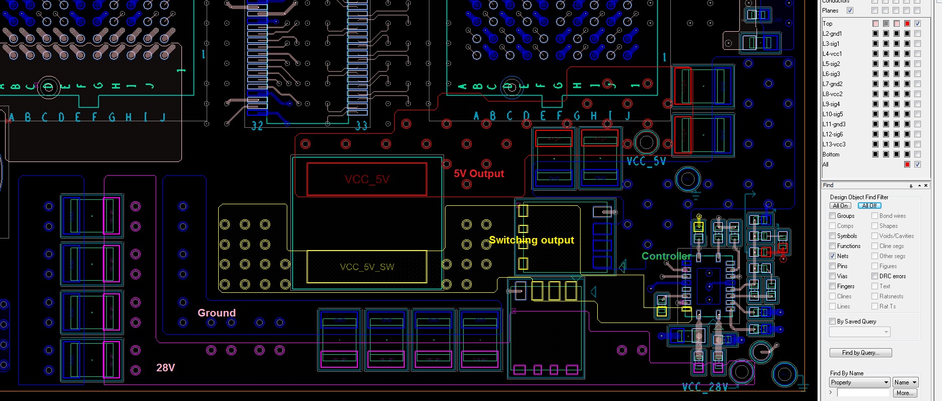

We are working with the LM25145RGYR in one of our boards.

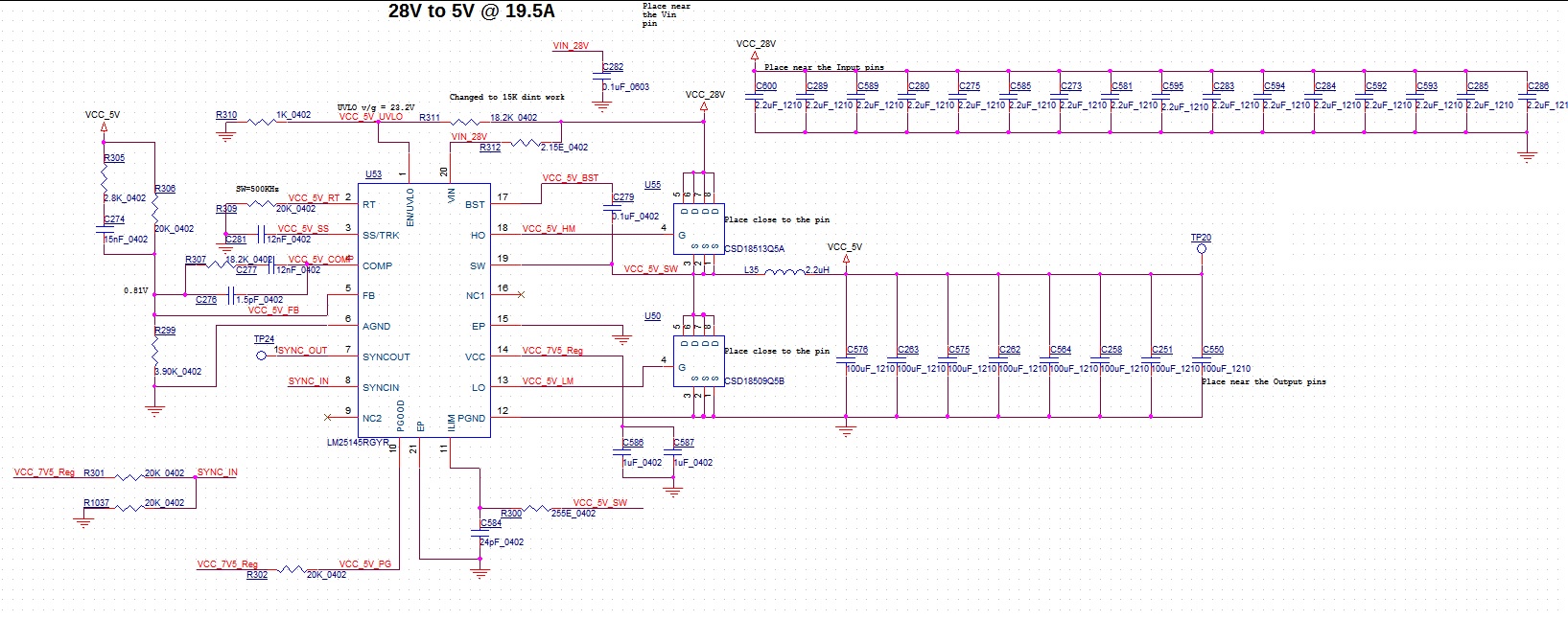

We are generating a 5V from 28V with this circuit. Below is the schematic of the same.

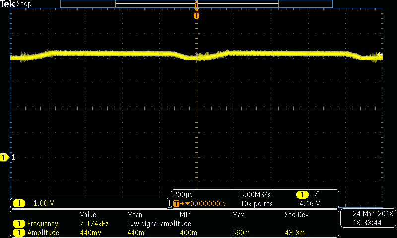

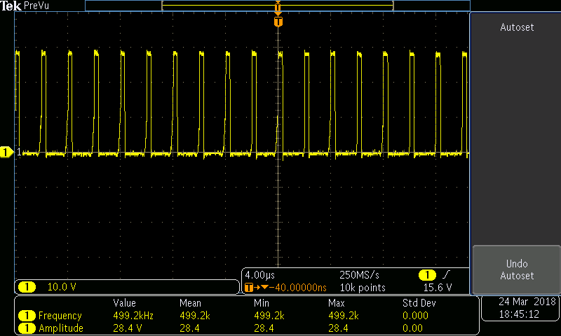

We have observed the output voltage is at 1.1V. and there is a light sound coming out from the IC.
We tried probing the SS pin with a multimeter and found that the voltage is 150mV.
Also the other pins RT-0.99V, Comp -330mV, 7.5VRegout -6.44V, Sync IN- 2.1V, SW-180mV, PG -0V.
Has anyone seen this behavior?
Can anyone please help me to move forward.
