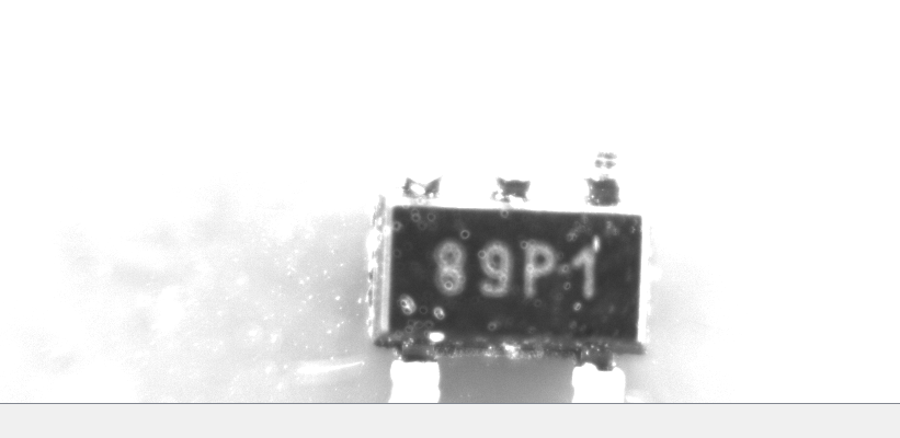

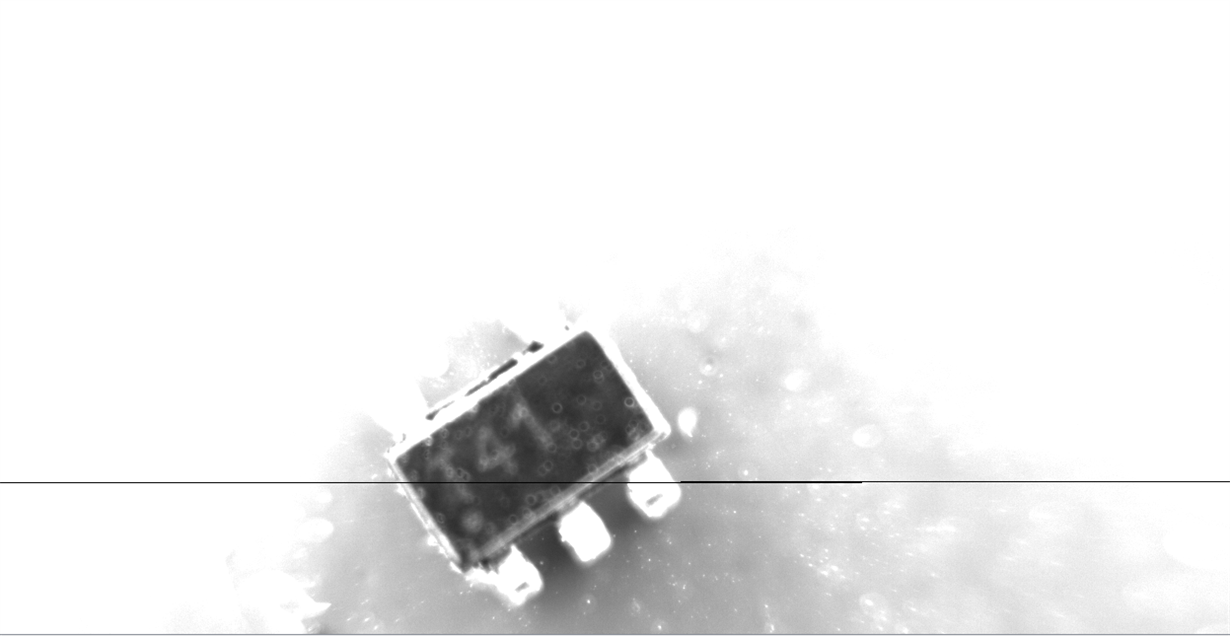

The problem was, the "device mark" was T41 (Fixed 5,0V).
The only visible difference was that the regulators that was responding as the adjustable had a mark in it's botton "89P1", as the new fixed ones didn't have any.

    Would you be able to provide some more information about these devices that were supposed to be fixed, but came out as adjustable? Do you have any of the lot information that should be printed on the reel that these device came on? The T41 marking is the topside marking for the fixed 5V regulator, but I cannot find any reference to a top or bottom side marking of "89P1". If you would be able to help us get the part number and a picture of the reel label I can help better trace where these devices came from.

    i took some photos of the TPS:
    Top VIew:
    Botton View:

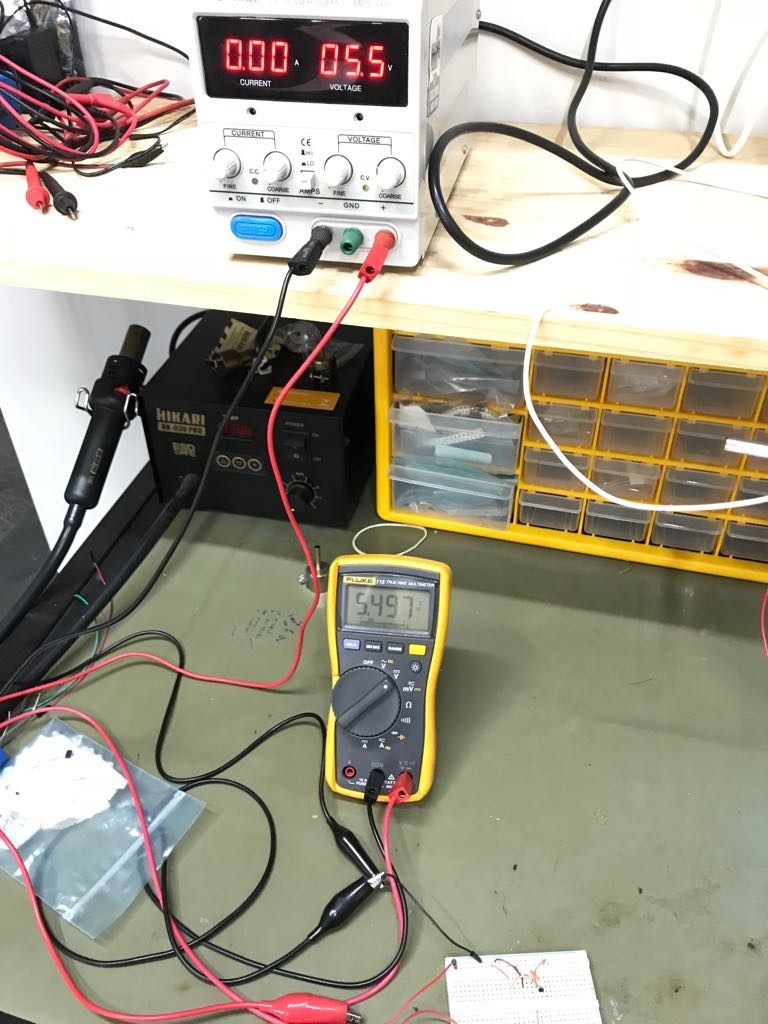

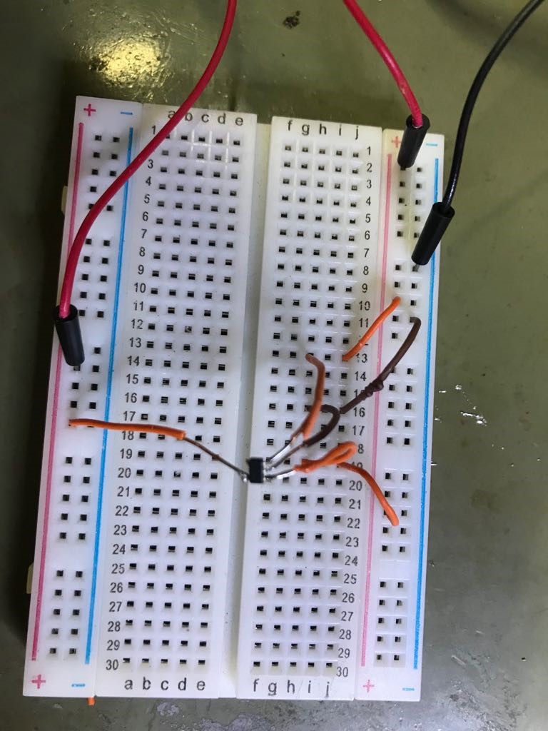

    In the video i'm shortening output with NR/FB and it works exactly like the adjustable TPS. Without the short circuit the output is less than 0,5V the input, i suppose it's just the circuit dropout.
    Protoboard photo:
    Dropout photo:
    I'm waiting the assembly company to send the the reel information, i haven't found any information about the botton code, but i thought it was some kind of productioin traceability.
  • Hi Rodrigo,
    It looks like this could potentially be a counterfeit device. I have attached a link to our anti-counterfeit policy www.ti.com/.../anti-counterfeit.html
    If you are able to get a picture of the reel information I will be able to confirm this for you.

  • Hi Rodrigo,
    There are some TPS732 that do have a bottom side marking, but the bottom side marking is not specific to a single voltage version. In order to figure out if this device should have had a bottom side marking we will need the reel information. If you would like to return the parts for further analysis more information can be found on that here: www.ti.com/.../customer-returns.html
