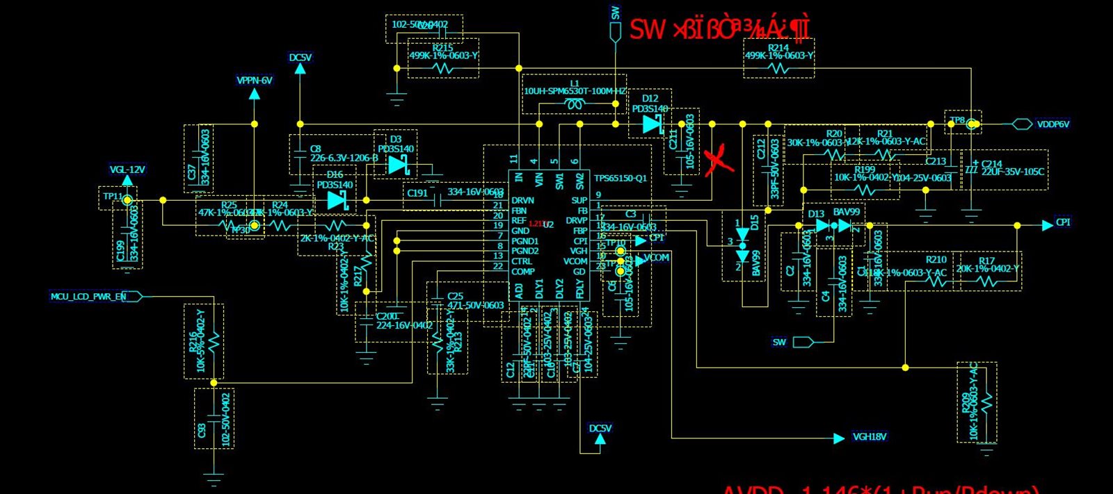

Hi team,
My customer are using TPS65150, but the output is abnormal, and the boost output is the same as Vin. VGH and VGL are 0V. The schematic is as follows:
Do you have any comments?

    We tried to disconnect the SUP pin with the boost output, the boost output turns right. It's so weird.
    We also checked the all the capacitors and resistors, they are all correct.
    Cera
    We found that if we set the boost output to 13.5V, it works. But when we set it to less than 11V, the output is wrong, and the chip seems not working.
    The VGH is 18V and VGL is -12V.

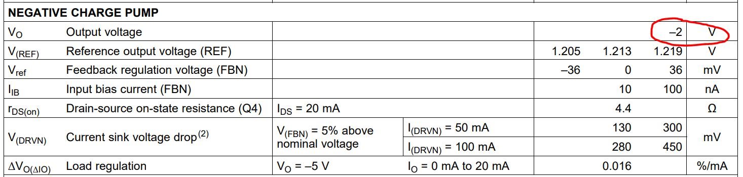

    1. Is there any threshold for the boost output voltage? Or is there any limitation for the VGL and boost output?
    2. As you can see in my schematic, the VGH is set to 18V. But the output is 23V.  Do you know why?
    3. What's the meaning of VGL output voltage? Any VGL smaller than -2V is ok?

  • Hello Cera,
    FDLY makes sure that the whole IC shuts down if one of the outputs falls out of regulation for too long. Please check the datasheet for the timing. You can disable FDLY by connecting the pin directly to VIN.
    With the voltages you mention above, I am sure that the problem is caused by the VGL charge pump. The negative charge pump is configured as a inverter and therefore cannot deliver more than -Vs+2*(diode drop). Therefore it is not possible in this configuration to create -12V from -11V. See more details on the function of the charge pumps in this application note: www.ti.com/.../slva794
    If you are adding a second stage to the negative charge pump, the circuit will function properly.
    Brigitte
  • Hi Brigitte,
    Thanks for your help. I changed the VGL to -4V, it finally works.
