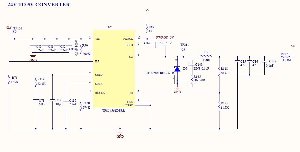

We have used TPS54561DPRR in our new design & testing the power supply is in progress
When we have connected the external load(1.25 ohm rheostat) by removing R117, observed the voltage drops on 5V net
Current drawn on 5V net= ~4A
Voltage dropped to=3.13V
