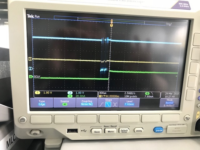

  I am trying to set the pwm values directly(i2c) in the following sequence:
      -write 16h - 0xFF (D1 is linked to red LED)
      - delay x secs
      - write 16h - 0x00
      - write  17h - 0xFF(D2 is linked to green LED)
But the red (D1) fades out slowly, I want it to switch off immediately and then green to turn on.

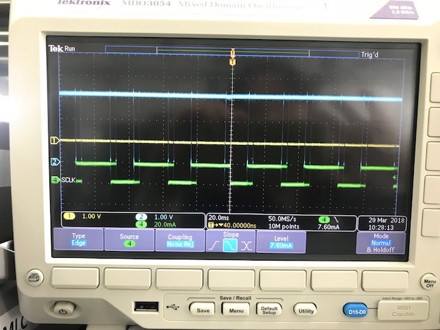

  • Hello Summer,
      I am setting the pwm of red as 0xFF then after a 20 secs, i send an i2c command to set red pwm to 0x00 and green pwm to 0xFF.
    The green LED switches on Immediately, but the Red LED turns off slowly after approx. 10 secs.
    This happens with all the LEDs, all the LEDs take the same approx. 10 Secs to switch off completely.
    The I2C sequence is:
    Chip enable,
    Internal Clock Set(write 0x43 to 36h)
    charge pump gain selection (write 0x5B to 36h)
    enable all 4 LEDs(write 0x0F to 03h)
    set pwm registrers....
  • Hi Fahad,
    I tried in the EVM and I can't dupliatce your board behavior in the EVM, would you refer my sample code and currenr wavaform and try it in your board?
    Thanks!
    Summer
