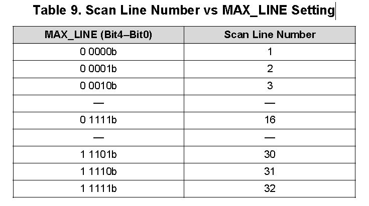

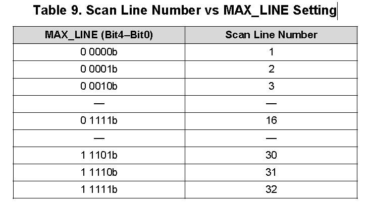

  • Hi, David,
    It's not correct about your understanding for MAX_LINE.
    As you can see from the Table 9 in SLVA645:
    MAX_LINE relates to scan line number, and scan line means you use MOSFET to scan. Although you use 2 daisy chained TLC5958, they control LEDs directly and you're not using MOSFET to scan. So the MAX_LINE is 0 because your scan line number is 1.

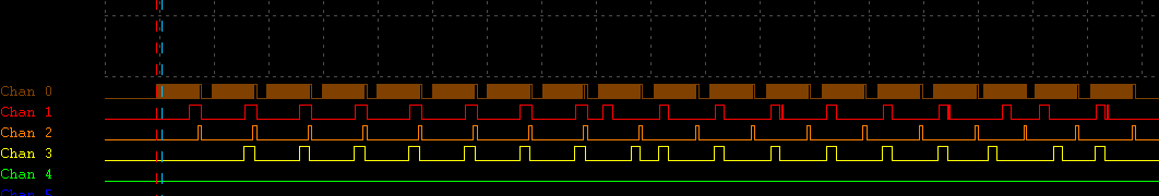

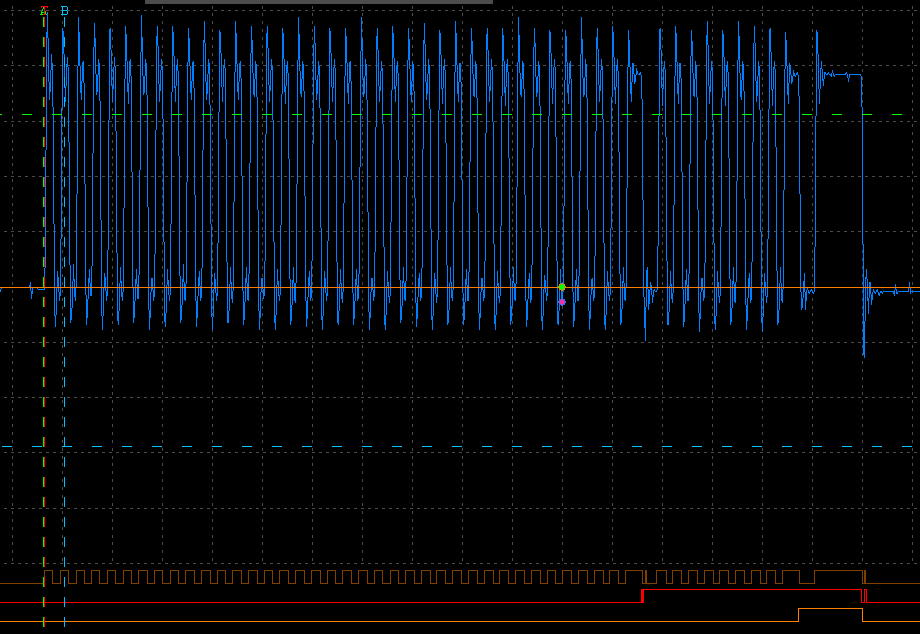

  • Hi Kenneth,
    I checked code and also looked at signals with my logic analyzer (see attached screen shot).  The code attempts to write colors to the first 18 LEDs, then set the remaining LEDs to off (RGB=0,0,0).
    It sets first 8 LEDs to Red, next 7 LEDs to Blue, next 1 LED to Green, next 2 LEDs Blue, next 236 LEDs are set to off.
    Results are 8 Red, followed by 7 Blue, followed by 2 Green, followed by 2 Blue.
    You can see in logic analyzer that Green write is not done any differently that red or blue writes (and color does not matter, even if I change all the colors, the effect is the same).
    It seems that with each additional TLC that is daisy chained, the number of "aliased" pixels increases by 1 (e.g. the 3rd TLC shows a blue then green LED, fourth shows 2 blue, then green LED, etc.)
    Logic Analyzer channels are set as follows (in attached screen)
    0. brown - SCLK
    1. red - SIN TLC 0
    2. orange - LAT
    3. yellow - SOUT TLC 0 (SIN TLC 1)
    I am running out of ideas.  Let me know if you have any other thoughts.  Also, given my schematic, is it correct to set MAX_LINE to 15?
    David

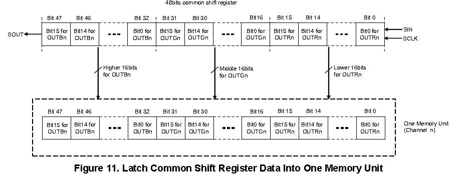

  • Hi, David,
    Firstly, since your scan line number is 16, it's correct to set MAX_LINE 15.
    One thing I want to check and confirm, as you can see from Figure 11, each WRTGS command writes 48-bit data, which is OUTBn/OUTGn/OUTRn(Bit15-Bit0), so you need 16 WRTGS commands to write one TLC5958 all channels GS data. Since you're using 2 chained TLC5958, your GS data should be writen like this: Chip 2 OUTB15-OUTR15(48bits)+ Chip 1 OUTB15-OUTR15(48bits), then one WRTGS command; Chip 2 OUTB14-OUTR14(48bits)+ Chip 1 OUTB14-OUTR14(48bits), then one WRTGS command;...;Chip 2 OUTB0-OUTR0(48bits)+ Chip 1 OUTB0-OUTR0(48bits), then one WRTGS command.
    And you need to send all 32 LEDs GS data together every time you want to change the GS status.

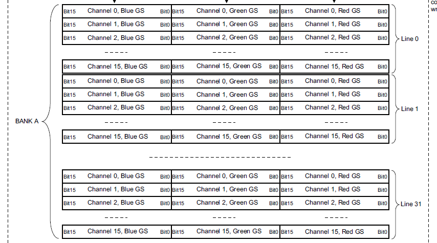

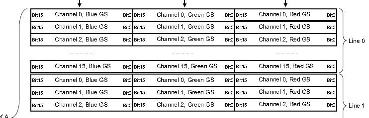

  • Hi Kenneth,
    I believe the sequence you specify for writing GS data is inconsistent with the app note/data sheet. All channels in Line 0 (first TLC) should be written before all channels in Line 1 (second TLC), etc. as shown in excerpt below.
    As seen in prior logic analyzer screen, I am sending GS data in this precise sequence.  I also attach another zoomed in screen of data being sent for a single channel.  Again, everything I am sending seems consistent with the data sheet or app note so I still don't know what is wrong.  Is there anyone else there you might ask that has further detailed expertise on TL5958?
    David

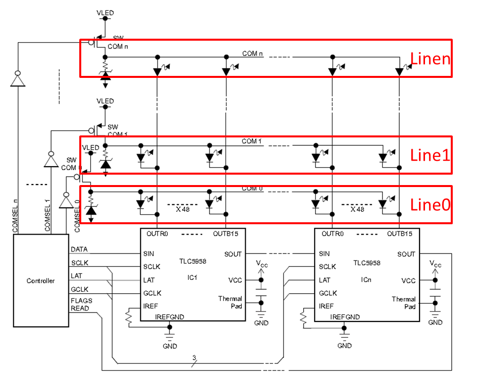

    1. Although you are using 8 dual-P MOS, you're not using multiplexing topology, and chip 0 is not line 0, while chip 1 is not line1.
    As you can see form the Typical Application Circuit in datasheet, multiplexing is usiing MOSFETs to drive Vled of each line, which is shared by all TLC5958 drivers:
    You can check with your circuit, you just use MOSFETs to control 16 TLC5958's Vled, which is not the same with above.
    In another word, I suppose you're controlling 16*16=256 RGB LEDs in total, if you're using 16 multiplexing topology, then only one TLC5958 + 8 dual-P MOSFET is needed.
    You can refer to the following circuit, it uses one TLC5957 + 5 Dual-P MOSFETs to drive 16*10=160 RGB LEDs.
    8765.TLC5957_10X16 RGB LED Matrix Schematic.PDF
    So your MAX_LINE sholud be 0 due to scan line number is 1. And you should connect all your Vled together because there's no need to switch Vled if you're not using Multiplexing.
    2.  If you remove you MOSFETs, or simple way to test, you switch ON all your MOSFETs, then you just have Line 0. The line in the following figure means you need to send all your GS data for 16 TLC5958 together since it's shift register inside.
    3. If you want to check agagin with 2 TLC5958, please select the first two TLC5958, and turn off Vcc for the rest of drivers.
    Then you need to send GS data as I described in last post. Thus it should be OK.
