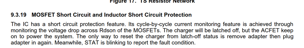

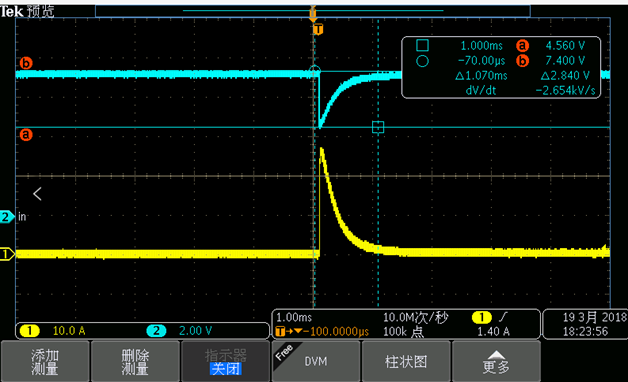

When our robot system is power on, it drains to much current from the battery (almost 40A, see below diagram). So BQ24133 is short circuit and end latched off.
If we  lower the draining current, we won't find this issue while we don't want to change our HW design now since we are really close to MP.
Does TI have any method can solve this issue except removing adapter then plug again? Thanks!
