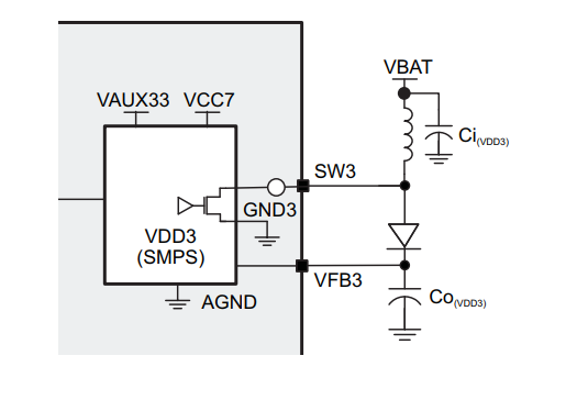

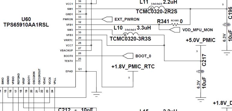

We've got TI's schematic review as below link. (all threads are locked so I can't make any more reply to that forum.)
https://e2e.ti.com/support/wireless_connectivity/wilink_wifi_bluetooth/f/307/p/655077/2410703#2410703
Thanks to TI, we succeeded in designing WL1837 to customers' application.

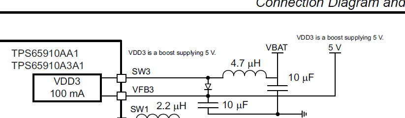

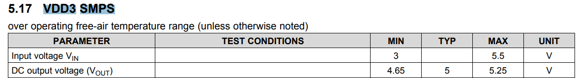

They're going to use 5V for the SW3 in the PMIC.
I think the circuit is wrong and the review is not working well.
So I ask for confirmation. Is SW3 step-up?

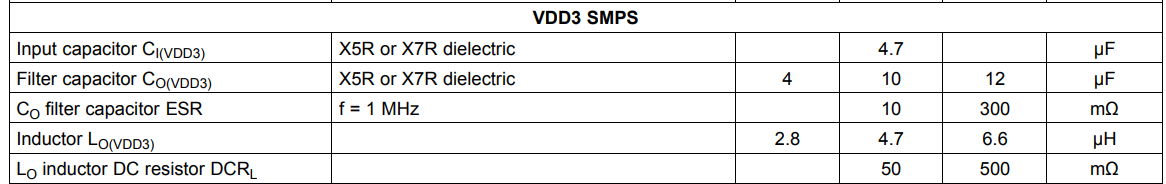

Please also inform the following diode specifications.
