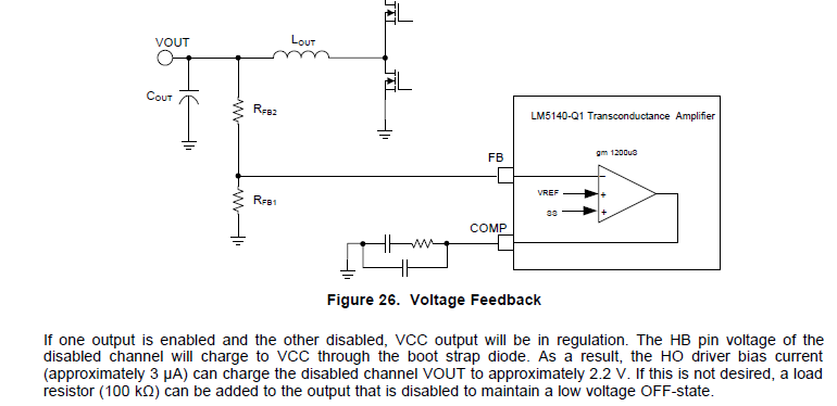

We got a question from the customer about LM5140-Q1.
Could you help us?
[Question]
- Why is 100kohm resistor required on the output?
