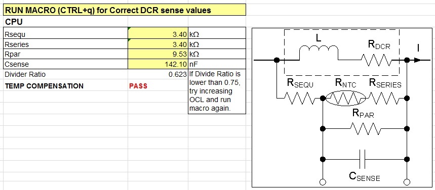

  • Hi Chenstu,
    On all three schematics I do not see a pull-up resistor on ALERT# but you only gave me one page. Can you check the other pages with that signal in the full schematic to make sure it's pulled up to 1.05V somewhere?
    Also, have you double checked your DCR sensing circuit to make sure the time constant is matched to the inductor? I've seen designs in the past shutdown at startup because of a mismatch between the DCR time constant and sense circuitry.
    If you have a start up waveform you could send me that would be helpful too.
    Carmen
  • One more thing - is the resistor from VOUT to the current sense circuitry (R232 in the VNN schematic) really 10kΩ? Usually that resistor is a much smaller value, like 10Ω. All three schematics show the same value and that could be your root cause too.
    Carmen
  • Hi Carmen,
    Thanks for your response, there's a pull-up resistor on ALERT# on other page.
    For the concern about 10KOhm, It's should be Rpar as pic below

  • Hi Chentsu,
    I see what you're saying about the 10kΩ resistor, sorry about that. I misread the schematic.
