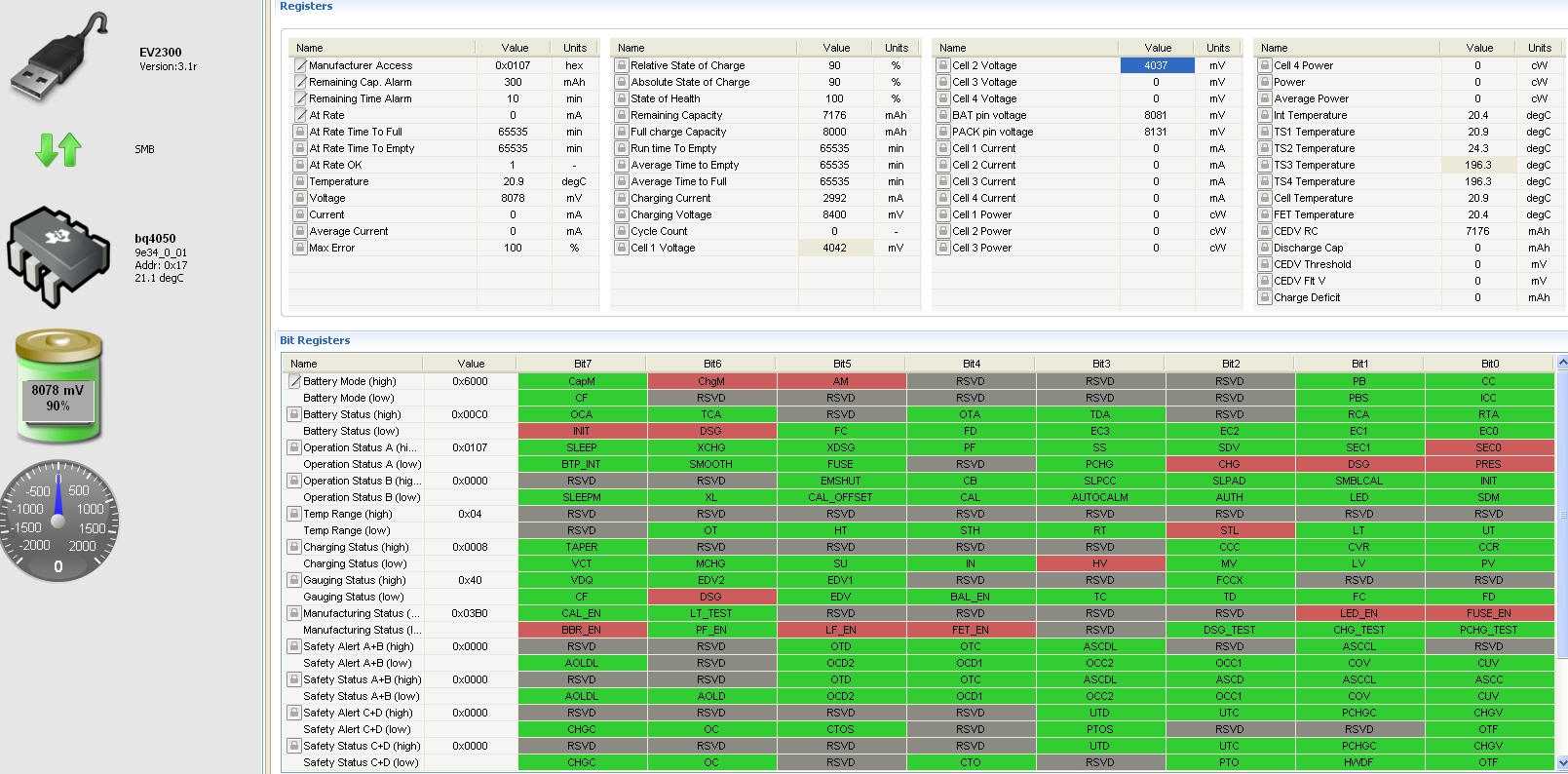

I am not able to put my device into sleep mode. To detect a SLEEP mode, I watch the current consumption with an amperemeter, since I obviously cannot read the status bits (SMBC/SMBD signals wake up the device).
I measure 350 µA in the battery branch, which corresponds to the NORMAL mode.
After meeting all conditions, I cannot see a current reduction in my battery branch. I would expect it going down to some 80 µA.
SLEEP mode conditions:
- "Settings/Configuration/DA Config[SLEEP]" = 1
- "Settings/Configuration/DA Config[NR]" = 1
- "Power/Sleep/Wake Comparator" = 625 µV / 10 mR = 62.5 mA
- "Power/Sleep/Voltage Time" = 5
- "Power/Sleep/Current Time" = 20
- "Power/Sleep/Bus Timeout" = 10
- OperationStatus()[SDM] = 0
- Current() = 0 ("Power/Sleep/Sleep Current" = 10 mA)
- no Safety or PF bit is set
- when deconnecting the SMBus, there is no voltage left at SMBC & SMBD, the pins are left floating.
Any help is appreciated.
Thanks in advance.
Frank
