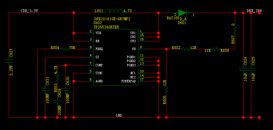

Please kindly help double check the schematic.
load is 500mA, diode: 0.7V, 0.75A. Isat of inductor is 1A+.
The compensation network need to be changed. suggest to change Rcomp=R603=200 hom. Ccomp=C629=100nF, C630=220pF.
