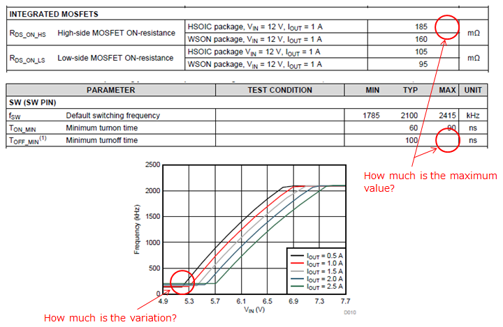

We got a question from the customer about LMR23625-Q1.
Could you help us?
[Question]
They are considering using this IC under the following condition.
 Vin=3.9V min
 Vout=3.3V
 Iout=1A
In this condition, the IC will enter the low dropout operation. Therefore they want to make sure whether the IC can regulate 3.3V output at 3.9V input voltage conditoin. Could you provide below datas?
 - How much is the maximum value of Rds_on_HS and Toff_min?
 - How much is the variation of the minimum switching frequency at low dropout condition?
They don't need guarantee. They will use it as reference.
