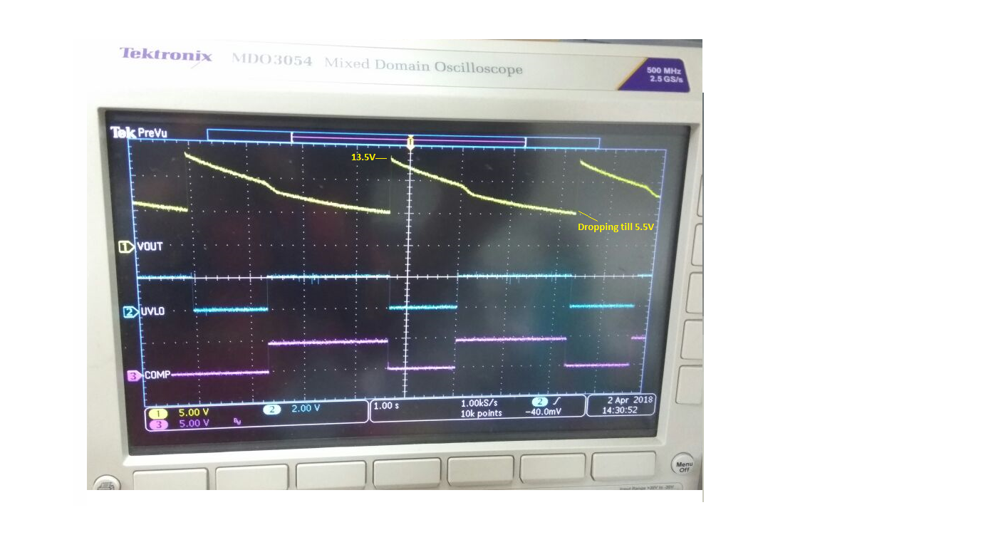

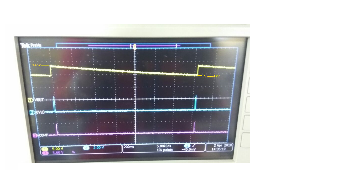

We are not able to understand why the IC is not regulating in some of the samples and what is that parameter that is forcing it to resume its regulation once it reaches to 5.6V. Please find below images captured in oscilloscope in faulty board and in healthy board.
WF1# Waveform captured at Vout, UVLO pin and COMP pin in healthy Board-
WF2# Waveform captured at Vout, UVLO pin and COMP pin in Faulty Board-

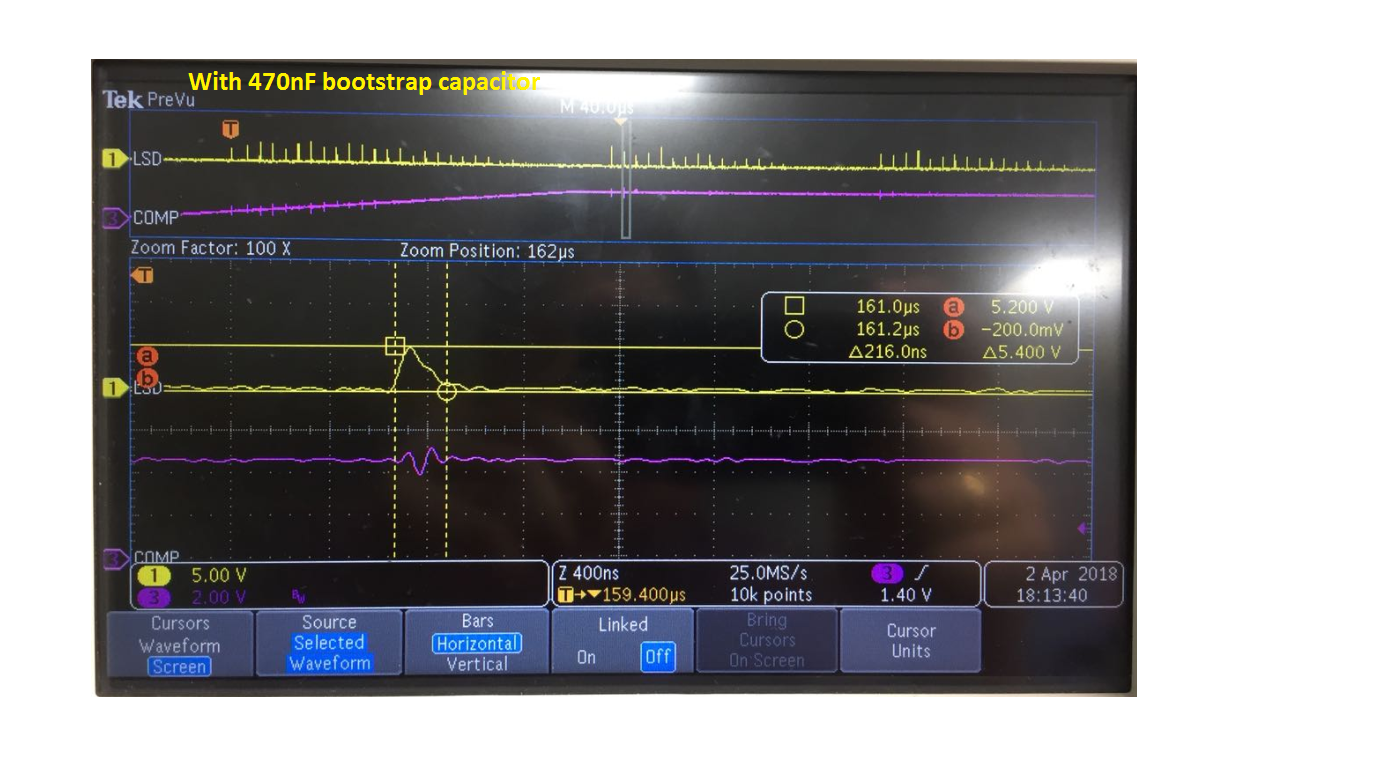

In our current design bootstrap capacitor is 470nF with which I checked the waveform at the gate of low side MOSFET. I observed that low side MOSFET is not turning ON properly .When i changed the value of bootstrap capacitor to 100nF, I could see proper pulses at the gate of low side MOSFET resulting in proper regulation. Can you please tell us what could be the reason of low side MOSFET not turning ON properly when the bootstrap capacitor is 470nF. In no load condition, which parameter decides the duty of low side MOSFET? Please find below the waveform captured at the gate of low side MOSFET and COMP pin with bootstrap capacitor 470nF and 100nF respectively.

  • Hello Jyoti,
    Do you have a schematic you can share?
    Without looking at the schematic and speculating here? I believe the issue is relating to the fact that the Boot UVLO is engaging and turning on the low side FET to charge the boot cap. In order to do this it will source current output the VCC cap (through Boot diode). If the Boot cap is relatively large, this can discharge the VCC cap and cause VCC UVLO to engage?
    A boot cap of 100nF should be more than sufficient for your design.
    Hope this helps?
    David.

  • Thanks Jyoti,
    Have you checked the Boot to Switch voltage with the 470nF Boot cap? It is likely that during light load operation (I am assuming in Diode Emulation Mode?) the the Low side pulse is not long enough to charge the Boot cap above and beyond the Boot to Switch UVLO? By replacing the 470nF with the 100nF cap, you are able to charge up the boot cap to a higher voltage in the same short period of time, and thus avoiding the Boot to Switch UVLO turn off threshold?
    Hope this helps?
    David.
