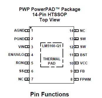

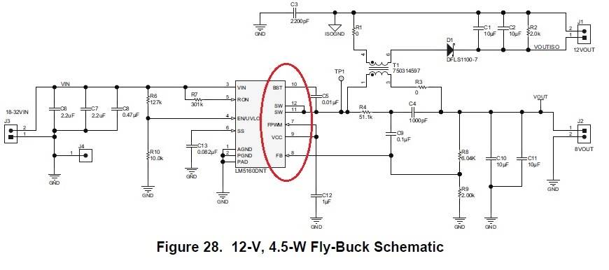

    1. On the datasheet for LM5160Q1 there are errors with the pin numbers. See the schematic below from page 22:
Compared to the pin definitions in the same document:
Please clarify this confusion.
