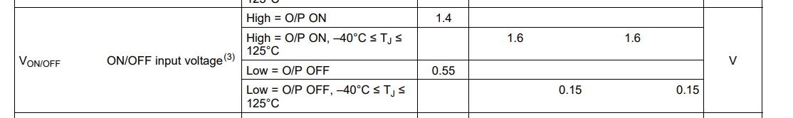

In datasheet, 1.6V is the minimum to enable and 0.15V is the maximum to disable. Questions:
  1. What is the accuracy for this threshold value?
  2. What happen to Vout if Ven falls in between 0.15V and 1.6V?
  3. Can I have the Ven vs Vout graph from 0V to 5V with Vin = 7.5V, Vout = 2.5V, I = 50mA?
Thanks.

    This is an old device, unfortunately, no enable thresholds curves are available in the datasheet. Based on the information provided in the datasheet, enable needs to be set higher than 1.6V to guarantee the ON state of the device; less than 0.15V to set the OFF state of the device.

    For this device, there is no Enable thresholds' curves available. If application needs to turn off the device, enable pin voltage needs to be lower than 0.15V; when you need the device to be on, the enable threshold needs to be higher than 1.6V. Between 0.15V to 1.6V, the on or off state of the device is not defined for this device.

    The enable function provided by this device does not have the accurate control on the threshold voltage for the device to turn on or off. The LDO will be turned once it exceeds a certain voltage between 0.15V and 1.6V.
    If accurate control on the turn on/off voltage is needed, you may need to consider adding a supervisor chip. You can find more information here: www.ti.com/.../products.html

    have you read section 8.2.2.3 of datasheet of LP2985-2.5? There you will find the statement:
    "To assure proper operation, the signal source used to drive the ON/OFF input must be able to swing above and
    below the specified turn-on/turn-off voltage thresholds listed in the Electrical Characteristics section under
    VON/OFF. To prevent mis-operation, the turn-on (and turn-off) voltage signals applied to the ON/OFF input must
    have a slew rate which is ≥ 40 mV/µs.
    CAUTION
    The regulator output voltage cannot be ensured if a slow-moving AC (or DC) signal is
    applied that is in the range between the specified turn-on and turn-off voltages listed
    under the electrical specification VON/OFF (see Electrical Characteristics)."
    This means, that the voltage at ON/OFF pin must not stay too long in the range between 0.15V and 1.6V and that changes from the proper low level to the proper high level, and vice versa, must be carried out with a minimum speed of 40mV/µs. Only then proper performance of regulator can be guaranteed.
