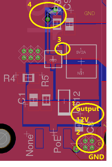

Yesterday I posted here in order to check if my boost converter layout should be suitable for the application and it didn't and for this reason, could someone could also check my 5V to 12V @ 0.5A dc dc converter using LMR62421X layout?

  • Hi Simone.
    Sorry for the delay.
    There are some comments for the layout.
    1 you should connect pin5 (AGND) to thermal pad.
    2 change C13 (output cap) close to output port.
    3 Do you have two layers? If it is, it is helpful to put some vies near pin1 (PGND)
    4 If you don’t have two layers, the cupper(I highlight) is not enough.
      Jing

  • Hi Simone
      It looks better. and I still have some suggestion and question.
    1 2 I have highlighted the output port and GND. I didn't get your point about "The pads near the out capacitor are a switch that,  when the switch is turned on,  shorts the OUT plane to the 12V trace."
    3 if you could put a via next GND pin, it will be better. because the will be a current flow in GND pin.
    4 I am just curious why you use two vias to connect R3 to EN, I think you could connect it directly in top layer.
    Jing

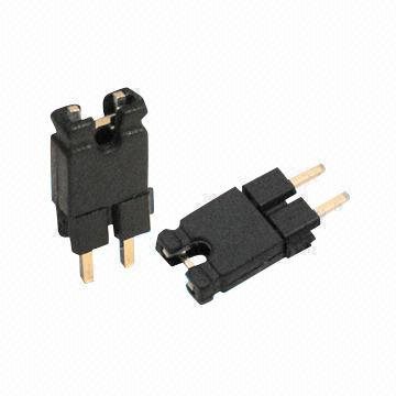

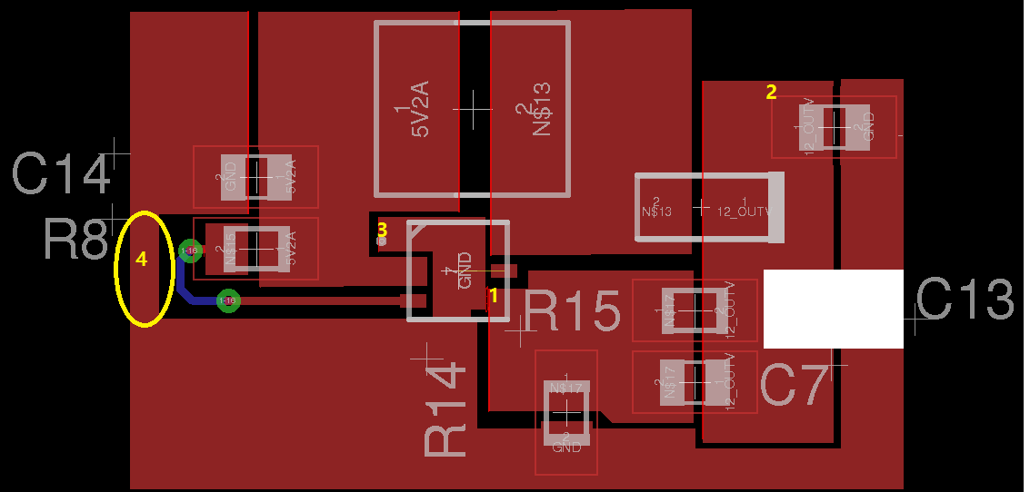

  • Hi Jing,
    I removed the vias as you mentioned in 4 and added one as you mentioned in 3. Regarding the first 2 points, the pads named "None" and "Poe" will be connected to the central one in order to decide or not to enable the 12V line using something like this
    to make te contact.
    Attached to this post is my final design.
