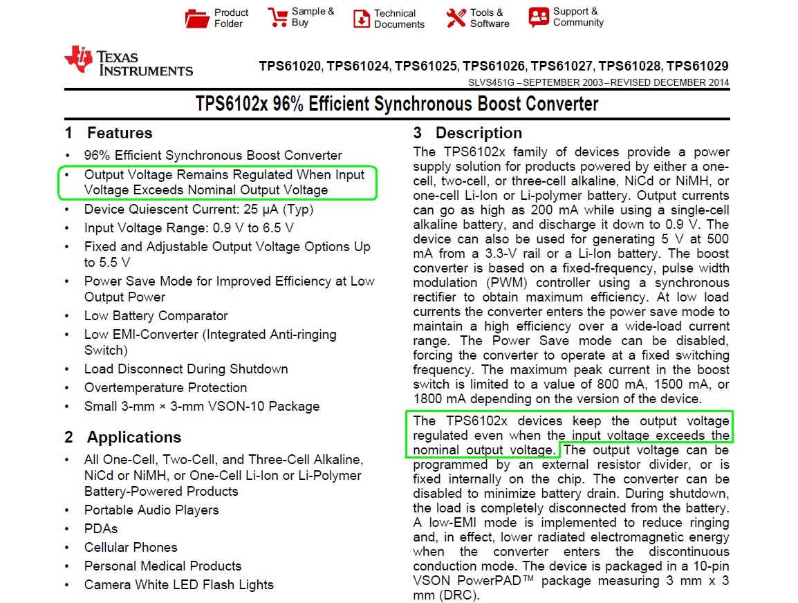

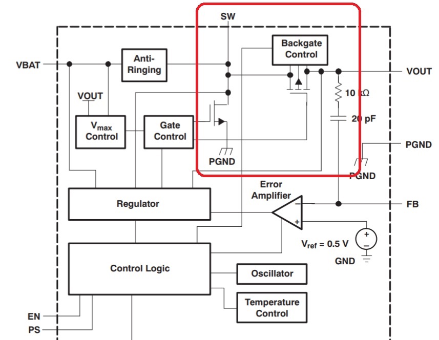

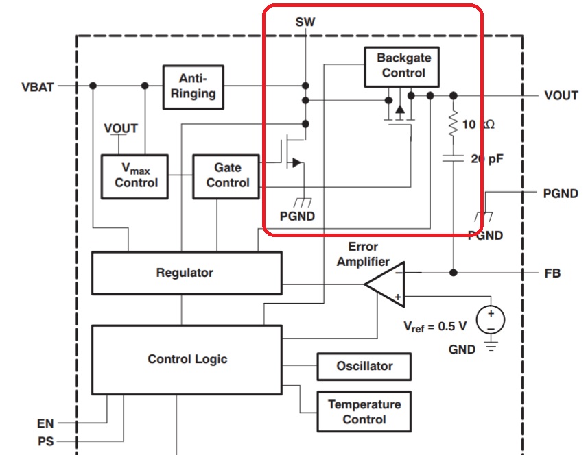

Hi Sir
May I know TPS61029 support "Vin=2V~3.4V or 5V to Vout=3.3V" ?
