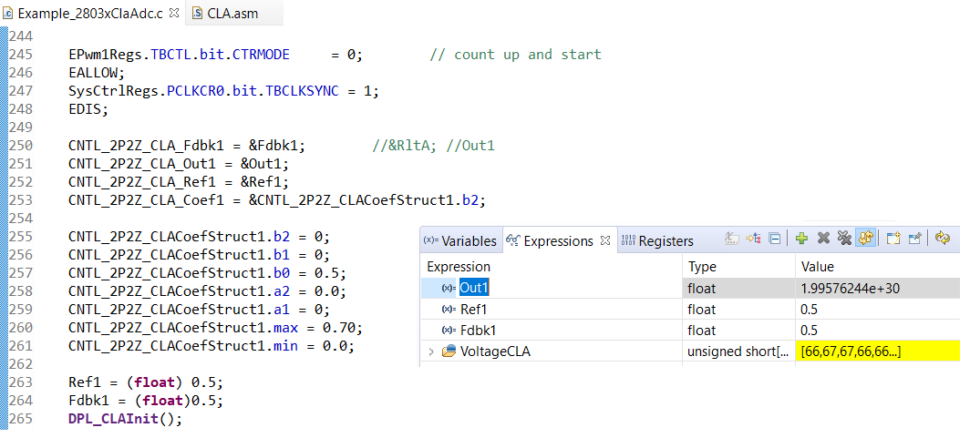

I am trying to use DPlib with CLA but am having problems. I added code for 2p2z from the CLA DPlib in an exisiting CLA example (cla_adc). I have constants as reference and feedback, just to see if it calculates correctly. In the 2p2z output I get a constant 1.99e30 for some reason.. See Figure below. Has anybody has similar problem before?
BR Niclas

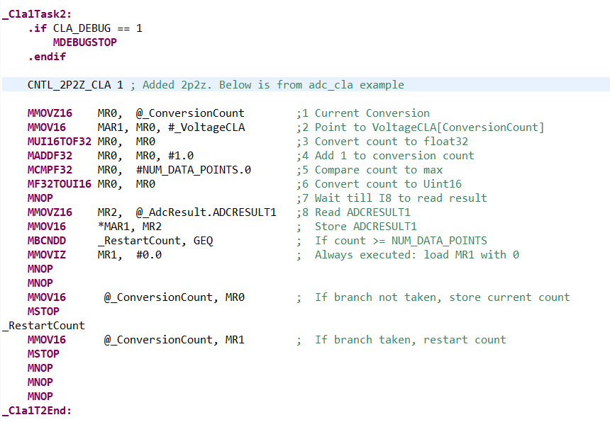

In the CLA.asm file I added the CNTL_2P2Z_CLA command like below. Everything else in the program code for adc_cla works.

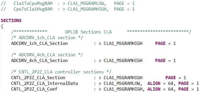

  • Here is the linker code for 2p2z CLA.

    1. Make sure the "Out" variable is in a CLA accessible space
    2. Also note, we do have CLA C compiler now for CLA and things may be much more easy to write and debug with it.. we also have the dp lib with CLA C.
  • Thanks for the reply! "Out" is accessible to the CLA, but I think this is related to memory somehow. The issue was gone after I added more code not related to 2p2z. But now the 2p2z is acting strangely again when I continue to add more things in the program.

  • Here is the code inside my linker file. Can you see if anything is bad?
    MEMORY { PAGE 0 : /* BEGIN is used for the "boot to SARAM" bootloader mode */ BEGIN : origin = 0x000000, length = 0x000002 RAMM1 : origin = 0x000480, length = 0x000380 /* on-chip RAM block M1 */ RAML0L1 : origin = 0x008000, length = 0x000C00 RAML3 : origin = 0x009000, length = 0x000C18 CLARAM : origin = 0x009C19, length = 0x0003E8 RESET : origin = 0x3FFFC0, length = 0x000002 IQTABLES : origin = 0x3FE000, length = 0x000B50 /* IQ Math Tables in Boot ROM */ IQTABLES2 : origin = 0x3FEB50, length = 0x00008C /* IQ Math Tables in Boot ROM */ IQTABLES3 : origin = 0x3FEBDC, length = 0x0000AA /* IQ Math Tables in Boot ROM */ BOOTROM : origin = 0x3FF27C, length = 0x000D44 PAGE 1 : BOOT_RSVD : origin = 0x000002, length = 0x00004E /* Part of M0, BOOT rom will use this for stack */ RAMM0 : origin = 0x000050, length = 0x0003B0 dataRAM : origin = 0x008C00, length = 0x000400 /* RAML2 */ CLA_CPU_MSGRAM : origin = 0x001480, length = 0x000080 CPU_CLA_MSGRAM : origin = 0x001500, length = 0x000080 } SECTIONS { /* Setup for "boot to SARAM" mode: The codestart section (found in DSP28_CodeStartBranch.asm) re-directs execution to the start of user code. */ codestart : > BEGIN, PAGE = 0 ramfuncs : > RAMM1 PAGE = 0 .text : >> RAML0L1 | RAML3, PAGE = 0 /* default code section */ .cinit : > RAMM1, PAGE = 0 /* initialised variables */ .pinit : > RAMM1, PAGE = 0 /* global constructor table */ .switch : > RAMM1, PAGE = 0 .reset : > RESET, PAGE = 0, TYPE = DSECT /* not used, */ .stack : > RAMM0, PAGE = 1 align(2) /* stack: even word alignment */ .ebss : > dataRAM, PAGE = 1 .econst : > dataRAM, PAGE = 1 .esysmem : > dataRAM, PAGE = 1 IQmath : > RAML0L1, PAGE = 0 IQmathTables : > IQTABLES, PAGE = 0, TYPE = NOLOAD Cla1Prog : LOAD = CLARAM, RUN = CLARAM, LOAD_START(_Cla1funcsLoadStart), LOAD_SIZE(_Cla1funcsLoadSize) RUN_START(_Cla1funcsRunStart), PAGE = 0 Cla1ToCpuMsgRAM : > CLA_CPU_MSGRAM, PAGE = 1 CpuToCla1MsgRAM : > CPU_CLA_MSGRAM, PAGE = 1 /* Uncomment the section below if calling the IQNexp() or IQexp() functions from the IQMath.lib library in order to utilize the relevant IQ Math table in Boot ROM (This saves space and Boot ROM is 1 wait-state). If this section is not uncommented, IQmathTables2 will be loaded into other memory (SARAM, Flash, etc.) and will take up space, but 0 wait-state is possible. */ /* IQmathTables2 : > IQTABLES2, PAGE = 0, TYPE = NOLOAD { IQmath.lib<IQNexpTable.obj> (IQmathTablesRam) } */ /* Uncomment the section below if calling the IQNasin() or IQasin() functions from the IQMath.lib library in order to utilize the relevant IQ Math table in Boot ROM (This saves space and Boot ROM is 1 wait-state). If this section is not uncommented, IQmathTables2 will be loaded into other memory (SARAM, Flash, etc.) and will take up space, but 0 wait-state is possible. */ /* IQmathTables3 : > IQTABLES3, PAGE = 0, TYPE = NOLOAD { IQmath.lib<IQNasinTable.obj> (IQmathTablesRam) } */ } SECTIONS { /************* DPLIB Sections C28x ************************/ /* ADCDRV_1ch section */ ADCDRV_1ch_Section : > dataRAM PAGE = 1 /* ADCDRV_4ch section */ ADCDRV_4ch_Section : > dataRAM PAGE = 1 /* CNTL_2P2Z section */ CNTL_2P2Z_Section : > dataRAM PAGE = 1 CNTL_2P2Z_InternalData : > dataRAM PAGE = 1 CNTL_2P2Z_Coef : > dataRAM PAGE = 1 /* CNTL_3P3Z section */ CNTL_3P3Z_Section : > dataRAM PAGE = 1 CNTL_3P3Z_InternalData : > dataRAM PAGE = 1 CNTL_3P3Z_Coef : > dataRAM PAGE = 1 /*DLOG_4CH section */ DLOG_4CH_Section : > dataRAM PAGE = 1 DLOG_BUFF : > dataRAM PAGE = 1 /*MATH_EMAVG section */ MATH_EMAVG_Section : > dataRAM PAGE = 1 /*PFC_ICMD section*/ PFC_ICMD_Section : > dataRAM PAGE = 1 /*PFC_INVSQR section*/ PFC_INVSQR_Section : > dataRAM PAGE = 1 /* PWMDRV_1ch driver section */ PWMDRV_1ch_Section : > dataRAM PAGE = 1 /* PWMDRV_1chHiRes driver section */ PWMDRV_1chHiRes_Section : > dataRAM PAGE = 1 /* PWMDRV_PFC2PhiL driver section */ PWMDRV_PFC2PhiL_Section : > dataRAM PAGE = 1 /* PWMDRV_PSFB driver section */ PWMDRV_PSFB_Section : > dataRAM PAGE = 1 /* PWMDRV_DualUpDwnCnt driver section */ PWMDRV_DualUpDwnCnt_Section : > dataRAM PAGE = 1 /* PWMDRV_ComplPairDB driver section */ PWMDRV_ComplPairDB_Section : > dataRAM PAGE = 1 /* ZeroNet_Section */ ZeroNet_Section : > dataRAM PAGE = 1 /************* DPLIB Sections CLA ************************/ /* ADCDRV_1ch_CLA section */ ADCDRV_1ch_CLA_Section : > CPU_CLA_MSGRAM PAGE = 1 /* ADCDRV_4ch_CLA section */ ADCDRV_4ch_CLA_Section : > CPU_CLA_MSGRAM PAGE = 1 /* CNTL_2P2Z_CLA controller sections */ CNTL_2P2Z_CLA_Section : > CPU_CLA_MSGRAM PAGE = 1 CNTL_2P2Z_CLA_InternalData : > CLA_CPU_MSGRAM PAGE = 1 CNTL_2P2Z_CLA_Coef : > CPU_CLA_MSGRAM PAGE = 1 /* CNTL_3P3Z_CLA controller sections */ CNTL_3P3Z_CLA_Section : > CPU_CLA_MSGRAM PAGE = 1 CNTL_3P3Z_CLA_InternalData : > CLA_CPU_MSGRAM PAGE = 1 CNTL_3P3Z_CLA_Coef : > CPU_CLA_MSGRAM PAGE = 1 /*MATH_EMAVG_CLA sections */ MATH_EMAVG_CLA_Section : > CPU_CLA_MSGRAM PAGE = 1 MATH_EMAVG_CLA_InternalData : > CPU_CLA_MSGRAM PAGE = 1 /*PFC_ICMD_CLA sections*/ PFC_ICMD_CLA_Section : > CPU_CLA_MSGRAM PAGE = 1 PFC_ICMD_CLA_InternalData : > CPU_CLA_MSGRAM PAGE = 1 /*PFC_INVSQR_CLA sections*/ PFC_INVSQR_CLA_Section : > CPU_CLA_MSGRAM PAGE = 1 PFC_INVSQR_CLA_InternalData : > CPU_CLA_MSGRAM PAGE = 1 /* PWMDRV_1ch_CLA driver section */ PWMDRV_1ch_CLA_Section : > CPU_CLA_MSGRAM PAGE = 1 /* PWMDRV_1chHiRes_CLA driver section */ PWMDRV_1chHiRes_CLA_Section : > CPU_CLA_MSGRAM PAGE = 1 /* PWMDRV_PFC2PhiL driver section */ PWMDRV_PFC2PhiL_CLA_Section : > CPU_CLA_MSGRAM PAGE = 1 /* PWMDRV_PSFB_CLA driver section */ PWMDRV_PSFB_CLA_Section : > CPU_CLA_MSGRAM PAGE = 1 /* PWMDRV_DualUpDwnCnt_CLA driver section */ PWMDRV_DualUpDwnCnt_CLA_Section : > CPU_CLA_MSGRAM PAGE = 1 /* PWMDRV_ComplPairDB_CLA driver section */ PWMDRV_ComplPairDB_CLA_Section : > CPU_CLA_MSGRAM PAGE = 1 /* ZeroNetCLA_Section */ ZeroNetCLA_Section : > CPU_CLA_MSGRAM PAGE = 1 }
