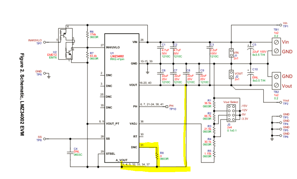

Dear Sir/Madam,
As for LMZ34002's datasheet
it stated that CLK  pin#31, it was informed " If unused, isolate this pin from any other signal" in the datasheet and I assumed pin#31 should be NC since I am not using any external clock.
On the other hand, i noticed CLK pin#31 was connected Vout in EVM circuit.
Which is correct?
