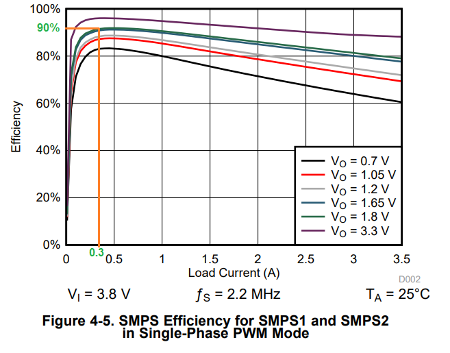

  • Hi Murthy,
    Thanks a lot for the response.
    I understood the concept of the junction temperature rise.
    For confirming the maximum power loss in the device, Please go through following:
    Considering rail: 1.8 V
    Output current : 300 mA
    Efficiency = 90%
    Total input power = (1.8*300)/(0.9) = 600 mW.
    Please confirm.
    Vishnu
  • Hi Vishnu,
    You can follow the below equations to calculate the power dissipation:
    Overall BUCKx power losses including inductor losses:
    PD_BUCKx = Vout * Iout * ((1-efficiency)/ efficiency)
    Inductor power losses:
    PD_Inductor = Iout*Iout* R_DCR
    Power losses inside the device due to BUCKx:
    PD_BUCKx_device = PD_BUCKx - PD_Inductor
    You can calculate the power dissipation for each regulators and add them to get total ~ power dissipation of the device.
    You can also refer to the below application note for more detailed understanding. Since efficiency for the BUCK is already provided, you dont need to calculate the internal losses due to switching and conduction separately and it is already included in the efficiency data.
    www.ti.com/.../slva390.pdf
    Murthy
