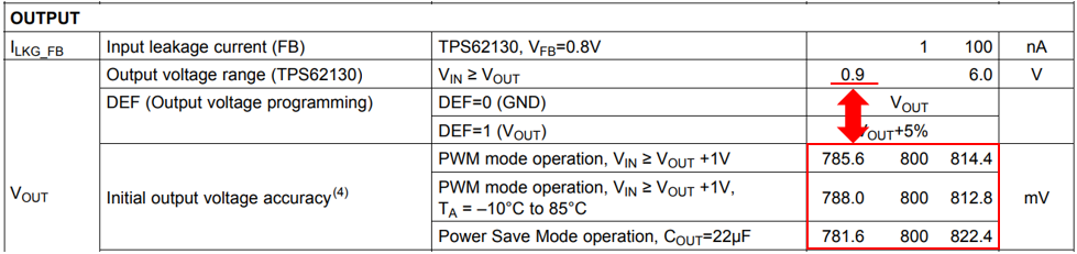

Could you tell me about TPS62130 out put voltage?
Customer sets the out put voltage to 0.86V.
The recommended minimum output voltage shown in the data sheet is 0.9V.
On the other hand, the Vref voltage is 0.8V.
Can TPS62130 set 0.86V?
If it is not good,
Please tell me the risk when setting it.
And Please tell me the background that 0.9V is specified as the minimum output voltage value.
