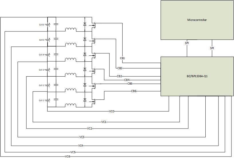

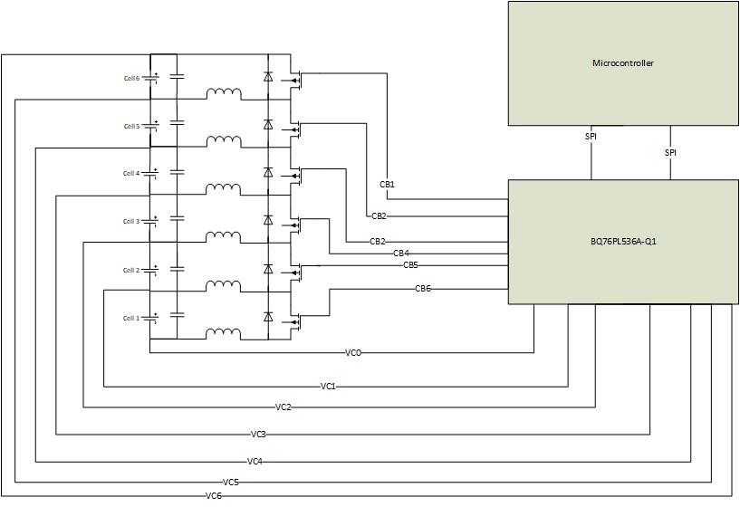

Can i use bq76PL536A-Q1 to drive external mosfets ?
Passive balancing is done with external FET.
Is this what you asking?
you can find below a simplified schematic on what i want to do with the BQ76PL536A-Q1.
So my question here is this schematic possible to do or not ?
can the BQ76PL536A-Q1 drive my mosfets and monitor the voltage of my 6 cells with a range of 0 V to 1.6 V of each cell ( the hole battery voltage is 6*1.6 = 9.6 V) ?
thanks for sharing the block diagram.
CB pin should be at least 1V but you also have to find the FET with VGS to support your voltage range.
