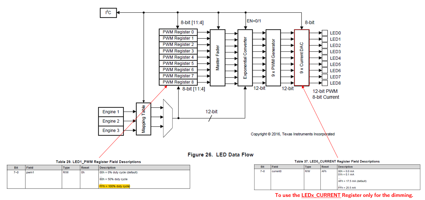

  • Hi Summer-san,
    I have additional questions.
    [Q1]
    LP5569 has three engines.
    Those engines can carry out the data which were written by I2C at the same time.
    Is my understanding correct?
    [Q2]
    I understand that those engines are related to PWM dimming only.
    Our customer would like to use the LEDx_CURRENT Register only for the dimming.
    (Then, they set PWM Registerx to 100% duty cycle.)
    Because, they need the DC dimming.
    [Q3]
    We understand that if they use 4 LP5569s, they can control(dimming) 36 LED by “LEDx_CURRENT Register ” at the time.
    For example, the time lag of “LP5569-1_LED0(first LED) and LP5569-4_LED8(last LED) are arund 90us (1/400kHz).
    Kanemaru
  • Hi, Kanemaru-san,
    Please refer to my comments for your questions.
    [Q1]:
    As you can see from8.1.1, the three engines can work at the same time but more than one engine cannot simultaneously control the same LED driver output.
    [Q2]:
    The engines also include other instructions like wait, rst, int, which is about delay, reset, interrrupt, and so on.
    But you are correct to set PWM Registerx to 100% duty cycle and change LEDx_CURRENT Register for DC dimming.
    [Q3]:
    Since the 400kHz is the clock frequency, everytime you send LEDx_CURRENT Register value for one chip, you need to send (1 byte chip ADDR + 1 byte register ADDR + 1 byte register value)*9 = 216 bit, which takes around 216*(1/400kHz)=540us. So the total time for sending four chips is around 2ms.
    This is the worst case, and if you use auto-increment, the time will be less.
    Please let me know if this solves your problem.
    Thanks.
    Kenneth

  • Hi Kenneth-san,
    Thank you always for your kind support.
    I have additional question.
    [Q4]
    I understand that it is reflected immediately if "Resister" is changed by I2C.
    <For example>
    “LED1_CURRENT Register” is changed from “AFh = 17.5 mA” to “FFh = 25.5 mA”.
    Then, LED1 current is changed immediately (there is not the time lag).
    [Q5]
    I understand that the internal engine can’t control “LEDx_CURRENT Register”.
    So, we can’t get the synchronization of " LEDx_CURRENT Register " even if we connected 32k clock to other LP5569.
    < Background >
    Our customer would like to remove the following time lag.
    Kanemaru
  • Hi, Kanemaru,
    For your [Q4], your understanding is correct.
    For [Q5], if customer want to sync all devices to same " LEDx_CURRENT Register " configuration, they can use 40h as the chip address and enable auto-increment function, then the total time lag for four chips at 400kHz will be (1 byte chip ADDR + 1 byte register ADDR + 1 byte register value*9 = 88 bit)*(1/400kHz)=220us.
    If customer needs to sync all devices to different configuration, using auto-increment, the time will be 220*4=880us. 2ms is the worst case for different configuration and not using auto-increment.
    Thanks.
    Kenneth
