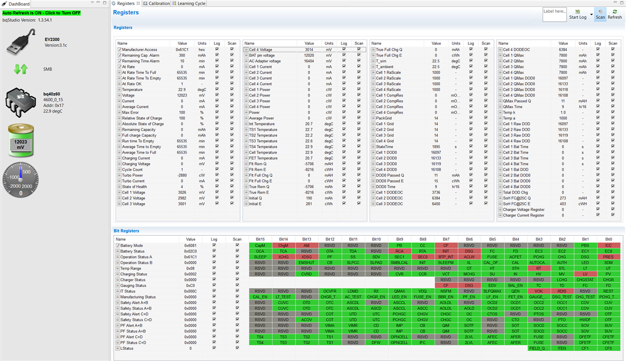

I am using a BQ40Z60 in a custom 4-cell Li-ion charger (4 x 3.7 V, 7800 mAh cells in series). We are using the EV2300 module and bq studio to set up the device. I am having issues setting up and calibrating the device.
I have carried out the following steps:
  1. Selected appropriate chemistry in bqStudio.
  2. Changed appropriate setting in the flash memory: use appropriate temperature for temperature detection, number of cells, voltage resolution etc. (see attached .gg file)
  3. Calibrated voltages for Cell 1, full batteries and AC adapter successfully.
  4. This is the first point where I believe there may be an issue. I am not sure as to where to carry out the current calibration from. Should this be applied to pin 1 when calibrating? I have not yet carried out the current calibration for this reason.
  5. Without calibration, we attempted to charge the batteries with the bq40z60 always choosing the pre-charging current as the charging current to use. This led to the overcurrent alarm flashing on and off and charging only available if we limit the current on the AC supply. The batteries stopped charging once the RSOC reached 100%, although the remaining and full charge capacities stated this was only 1800 mAh, 23% of the full charge capacity. Is this normal when you have not run the learning cycle at all, or would the chip not get closer to the actual theoretical value?
  6. I continued to run the learning cycle via the bqstudio software in manual mode. The discharge was at a through a 10 ohm resistor with a measured voltage across it of 14-16V giving 1400-1600 mA discharge through it. However bqstudio showed a current of approximately 2500 mA through each cell. Is this due to no current calibration or is it possibly something else?
  7. The learning cycle also ended after the relaxation period which is set to 6 hours in the software. Is it possible to run this manually (i.e. manually set the update status in flash memory to 04, discharge, relax, charge, relax etc) without using the built in learning cycle?
Please find attached the .gg files and a screenshot of the registers during relaxation of the discharged batteries.

  • Hi Swami,
    Thanks, I carried out the current calibration and that fixed a lot of the issues we were having. Since then I have been carrying out the learning cycle which is going well for the most part. However, I have encountered a few minor issues which I would appreciate your help in clearing up:
    1. While relaxing the batteries after the first charge to full, Qmax was not updated at this point and therefore the update status was not increased to 05 from 04 despite being in the REST state and relaxed for about 5 hours. Qmax was then updated after the following discharge to empty, giving much better values for the full charge capacity, state of health etc. I am hoping that the next charge in the learning cycle should fix this but would appreciate any insight you may have with this and why this may have happened so I can improve this in the future?
    2. During charging of the batteries I have some issues with the charging current.
      1. How is the charging current (set as 1920 mA in the attached register screenshot) set? I would expect this to be 1980 mA according to the Standard Temp Charging - Current Low value in the data memory. Why are these different?
      2. The currents I see at the Cells is significantly lower than the Charging Current above (~1300 mA compared to 1920 mA). Shouldn't these values be the same?
      3. What is more I see the cell currents oscillate between ~1300 mA and ~ 300 mA (see attached register screenshots). This seems to be due to the ACFET triggering on and off but I am not sure how to correct this. Do you have any advice?
    I have attached register screenshots and the new csv of the data memory. If you require any more details please let me know.

    Just wondering if someone has had some time to look at the issues I have been having?
    William
  • A log file of the charging sequence would be useful. Also take a look at SLUA750 to check your voltage resolution/ minimum charging voltage.
  • Thanks for the pointer to that document. I have checked the voltage resolution I should have and do I need to have the maximum out.  I have changed the minimum charging voltage from ~6500 to 8373. My maximum charging voltage according to SLUA750 is 16747 mV, which is below the full charge voltage of 16800 mV. Should I change the resistors which control this value or leave it as is?
    I have attached my log files for the learning cycle.
    William
    3704.LearningCycle1.logLearningCycle2.logLearningCycle3.log
  • hi William,
    Did you try to use the GPCRA0 tool www.ti.com/.../GPCRA0
    It will help you to calculate the optimized Qmax & Ra values instead of running a learning cycle.
    Alternatively you will find some good troubleshooting elements in the doc SLUA777
    www.ti.com/.../slua777
    David
