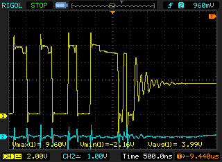

  • Hi Jeff,
    I’ve attached some oscilloscope screenshots for the nets that you mentioned (signal on channel 1). In all of them, channel 2 (in blue) is showing the INT output (which pulls low during charging). The D+/D- lines are connected to the USB-C connector which in turn goes to the charger (they are also connected to MCU pins configured as high-impedance inputs). The I2C register values are as follows:

    V(BAT):
    V(USB):
    V(SYS):
    V(SW):
  • Raphael,
    I have a few questions. Why is EN_NOBATOP bit (REG01B0) high? If a battery is attached, this bit is typically low. How is V(SW) close to 8V? When operating normally, the buck converter high side switch connects USB to SW so V(SW) should never be higher than V(USB), excluding ringing.
  • EN_NOBATOP was set high from trying to test various configuration settings. I have confirmed that the behavior is the same with EN_NOBATOP set low (which it should normally be). I also checked V(SW) again and I think the issue you noted was more around bad grounding during the measurement. Here you can see V(SW) in yellow and V(USB) in blue.

  • I disconnected the USB-C circuits (with no effect) and saw very similar unstable behavior when charging with the IN supply. However, upon further review, it appears that we are missing the 1uF capacitor on the DRV output. Adding this component seems to have stabilized things, but can you confirm that this would explain the behavior we were seeing?
  • Yes.  The DRV output is the output of a linear regulator that needs the 1uF for stability.  If you remove that cap and look at the voltage on oscilloscope, you will see it oscillating.
