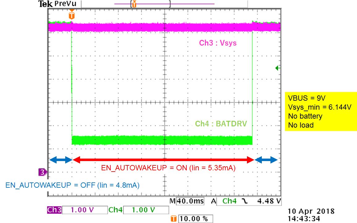

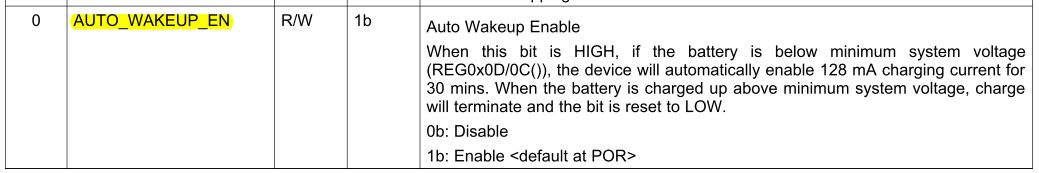

The customer would like to reduce quiescent current at PFM mode. And now they tried to disable Auto Wakeup function (AUTO_WAKEUP_EN = 0), then the quiescent current is reduced about 1mA. So please let me ask following question.

  1. Please let me know why the quiescent current is reduced by disabling Auto Wakeup function?
  2. Do you have any concern by using with disabling Auto Wakeup? I understand that 128mA charging does not start automatically if the battery is below minimum system voltage.

  • No battery
  • No load
  • Operate with VBUS

  • 1. The current consumption of auto wakeup is depended on the battery voltage. If the battery voltage is below Vsys_min setting, the charger would provide a small current to Vsrn terminal to bring the battery voltage up to Vsys_min setting. After Vsrn reaches Vsys_min, charging stops and BATDRV off.  So, the BATFET would be turned on and off depending on Vbat voltage.
    2. I don't have any concern about disable the auto wakeup function if the host controller can detect the battery insertion and send command to wake up a deeply discharged battery.
  • Hi Wang,
    I tired to measure input current with no battery and no load. Then I could see that BATDRV output goes low at enable AUTOWAKEUP and at this time the input current is increased approx. 0.5mA.
    Satoshi
