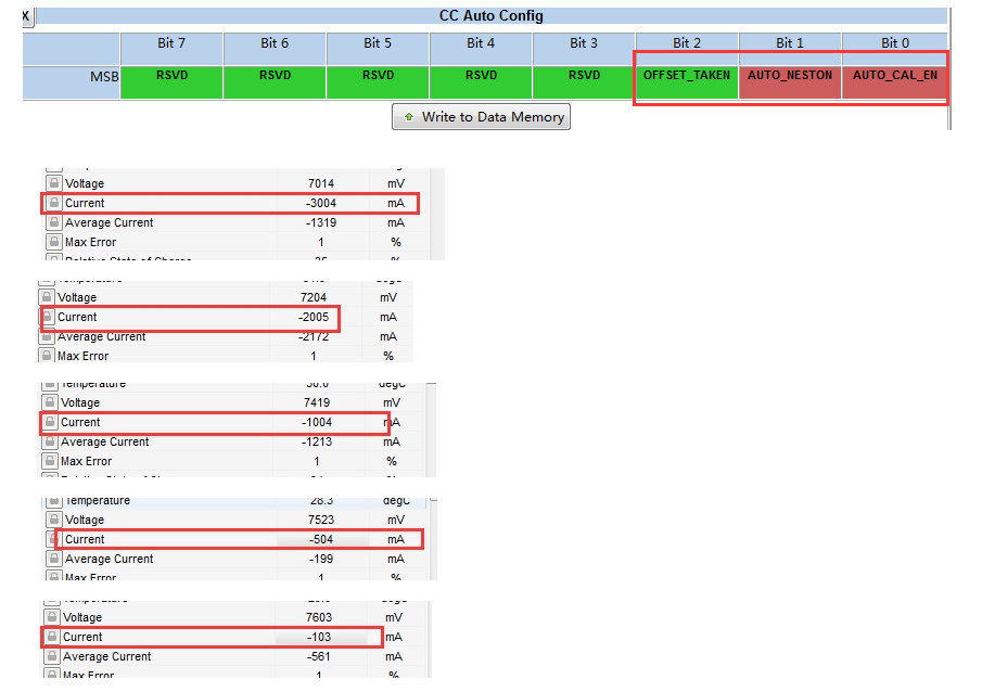

Hi
If Calibrate current with -1000mA, use the same E-load and set the same current value, BQstudio shows the current is -1004mA, it can not be calibrated to -1000mA.
Even calibrate other current value(e.g -100mA or -500mA or -2000mA or -3000mA), the deviation value BQStudio shows is still about 4mA.
However, CC Auto config()[OFFSET_TAKEN] or [AUTO_NESTON]=0, If Calibrate current with -1000mA, BQstudio shows the current is -1000mA.
With the same solution, there is no such issue found in PCBA in other project. Could you explain the reason?
In mass production, will there be any defect if either CC Auto config()[OFFSET_TAKEN] or [AUTO_NESTON] is set as 0?
