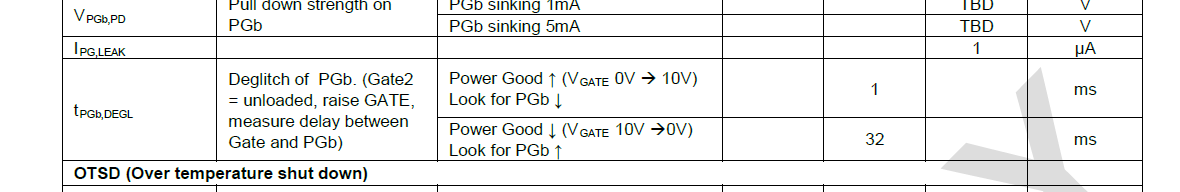

TPS23523: one question about the delay time of Power Good in TPS23523
Part Number: TPS23523
From below electrical table of TPS23523, the delay time of power good from low  to high.
Is it measured from Gate=0 to PG=high?
if Gate changed sever times with 32ms, power good would not change?
Can you give more comments for the inserting delay?
