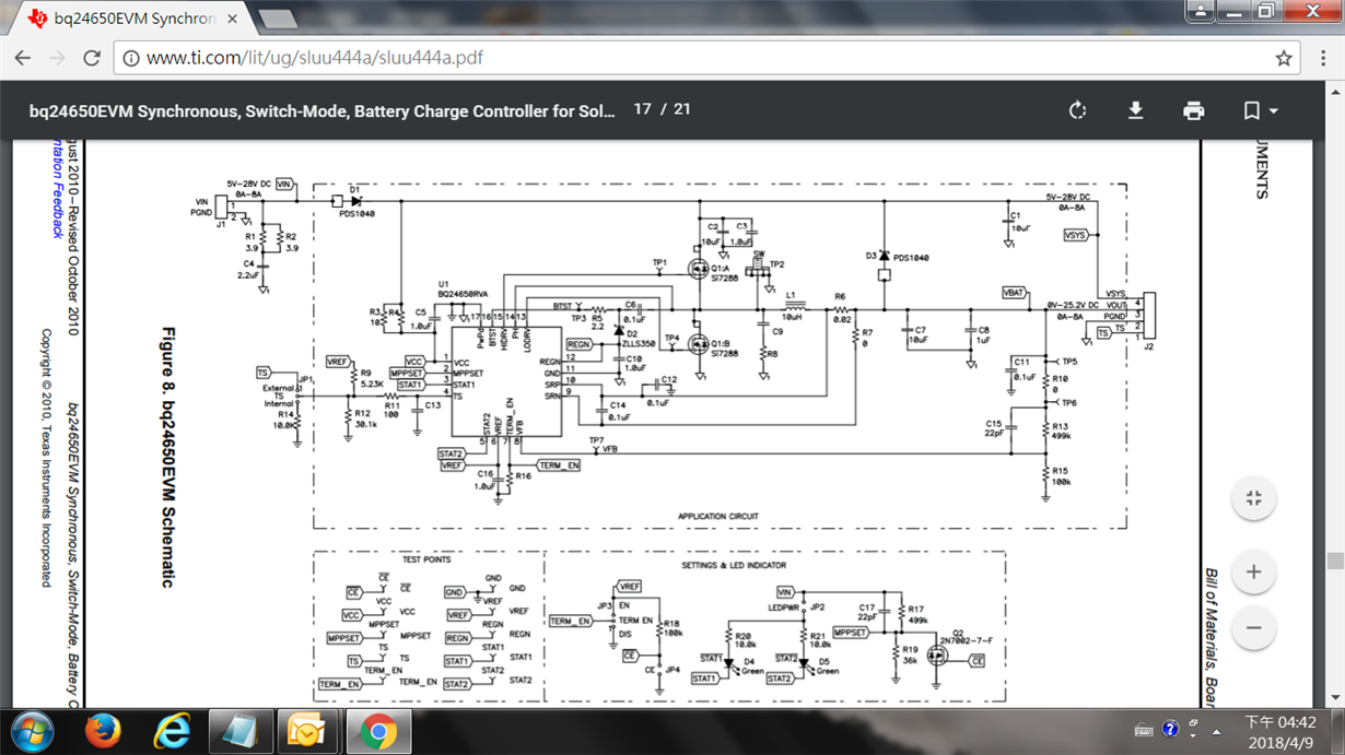

Our client use BQ24650 EVM-639, but we find the issue, if  R6  0.02 ohm change to 0.05ohm and R15 100K ohm change to 86.6k ohm
Input 12V, output charge 12v battery
JP1 EX
JP2 Enable
JP3 EX
JP4 Disable
but Voutput it`s cannot charge. have any idea for our reference.
If any, Please advise me.
Lawrence.
  • The bq24650 uses buck topology, which means the input voltage has to be higher than the output voltage in order to have the converter start working. To begin charging, VCC must be higher than SRN by at least 500 mV (otherwise, the device will be in sleep mode). Please make sure the voltage at VCC is at least 500mV higher than voltage on SRN.

  • HI jing
    we try EVM Board Chenng R19 36k to 100k ohm , So Vout & Pgnd can work on Bettery .
    but DC power supply CC & CV Vol 14.5V , but CC & CV Alwayes not steady (CC RED LED )
    jp 2-3 internol ,JP2 Enable ,jp3 1-2 ,JP4 Enable
  • Not sure I understand your question...
    What is the purpose of changing R19 to 100kohm?
    what is the charge current? What is the current limit on your DC power supply? Can you provide waveform on input voltage, input current, output voltage and output current?
  • Dear   jing
    Take my test files bq24650 EVM Board test no Charger.pdf
  • Please refer to the datasheet of the charging profile. I probably misunderstand your "CC/CV not steady" statement. What you are referring to is the power supply is not steady?
    Please use the bq246xx calculation tool in the bq24650 tools and software folder for the resistor calculation.
    I do not think the changes you made in the pdf file corresponds to your charging requirement. The MPPT value you set gives you around 7.2V which is only 50% of our power supply output. From your picture, I cannot tell what the current limit you have set on your power supply. If you see your power supply is not steady, you might drawing more current than your power supply current limit. In result, the input voltage will droop. Since you have see the MPPT to 7.2V, the input voltage to the charge will then be clamped at 7.2V which is lower than the output voltage. Thus converter turned off, then your input voltage recovers. Therefore, you will see the power supply goes between CC and CV mode.
    Also as a note, VFB resistor divider will not give you 12V battery regulation voltage.
